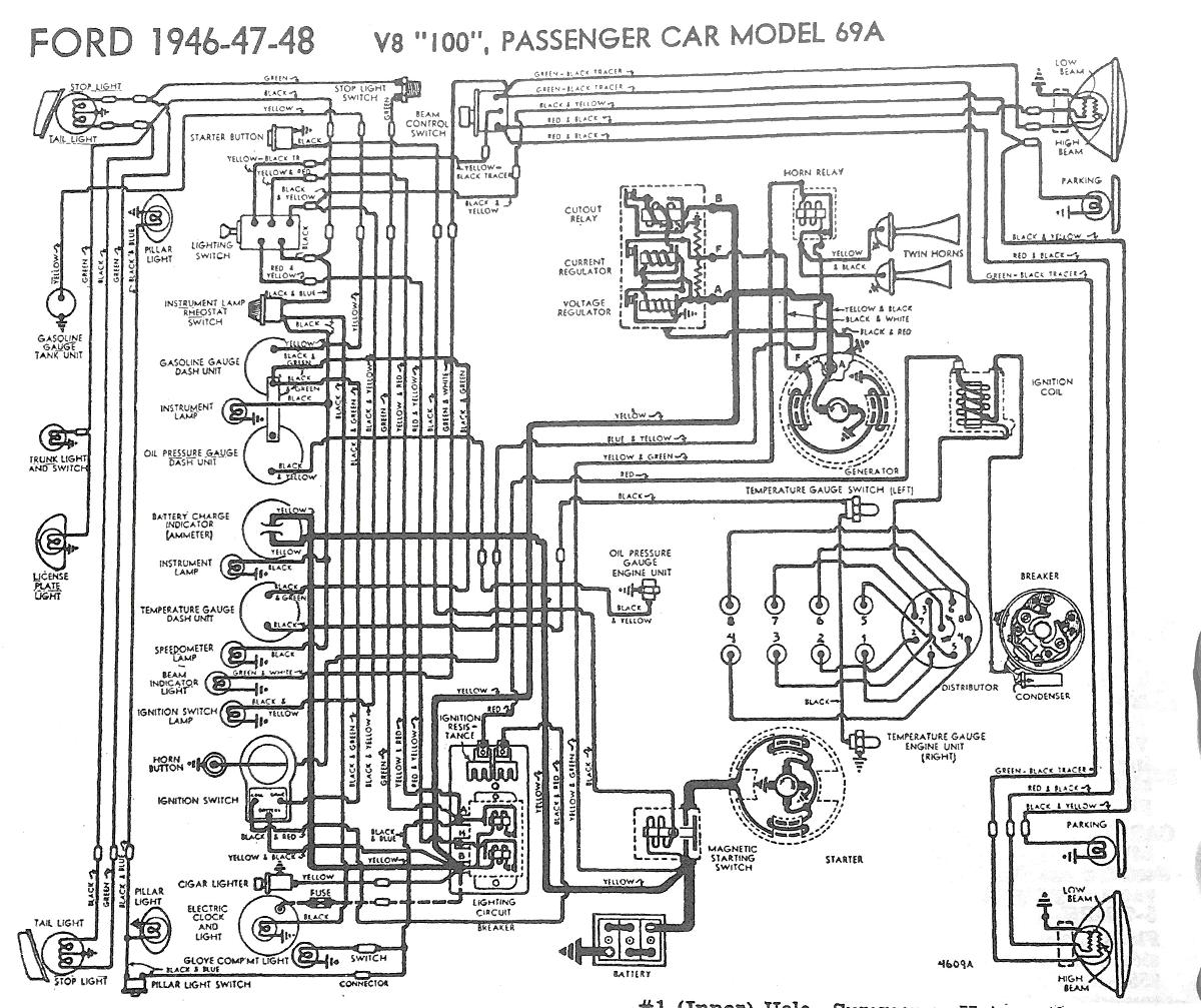

Where is the fuse for the dash gauge light
Thanks
John
I meant the gauge readings
This message was edited by oldford2 on 4-22-26 @ 12:08 PM
51woodie
04-22-2026 @ 12:28 PM
Posts: 575
Gauge power comes off the ignition switch, and the dash lights are fed from the headlight switch, neither have a distinct fuse. There is a breaker box (see attached diagram) up under the dash, along with the ignition resistor.
