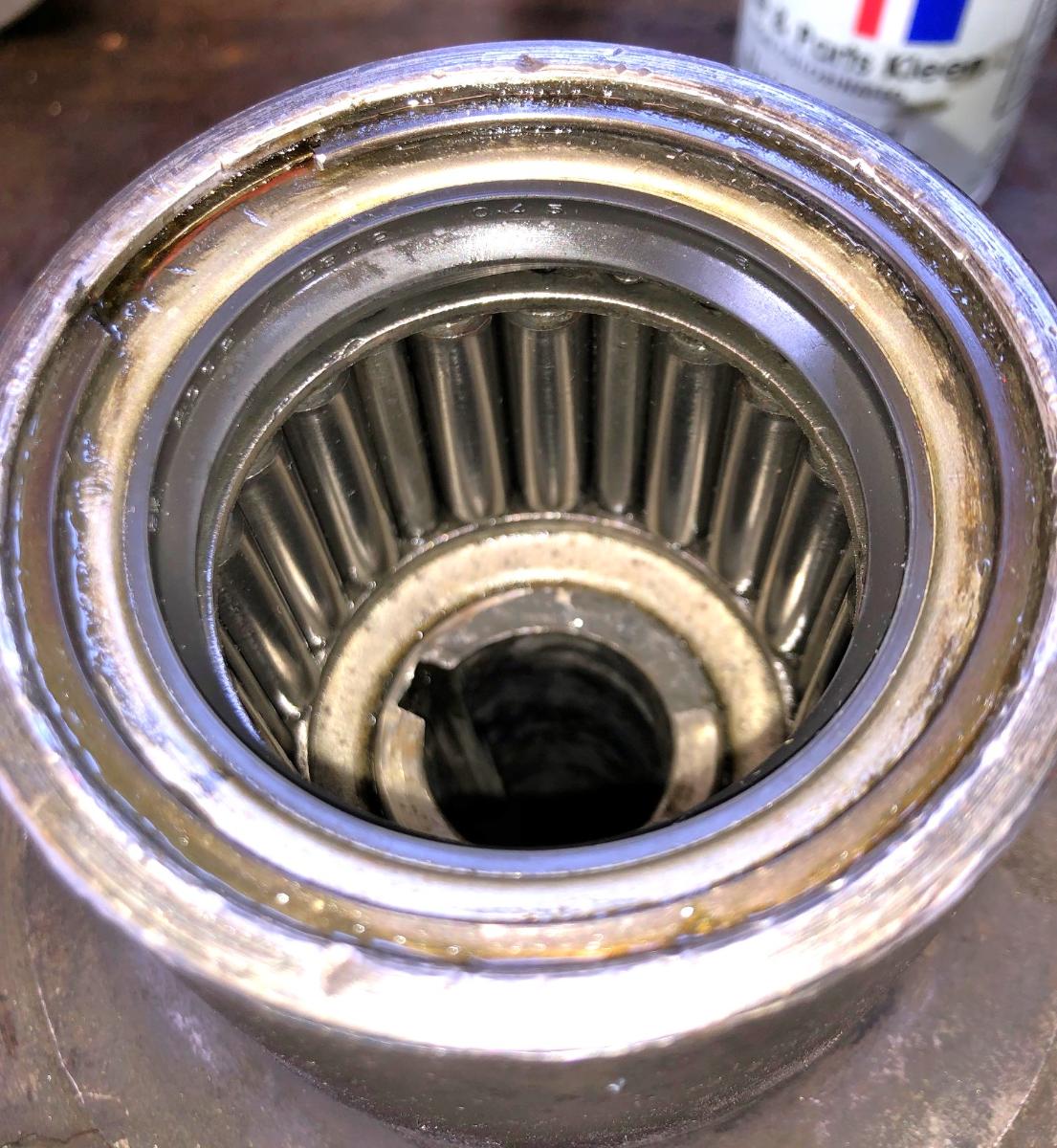

With limited response to my post, I thought it was best to pull the hubs and repack. Using my limited knowledge of tribology, I decided that the SL3131 I had left from previous service was good to use, as there was no oil/soap separation .
One side looked "greasy", while the other side looked dryer. I didn't pull the seals, just washed, flushed, blew dry then repacked.

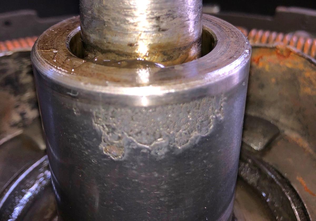

When you repack bearings, you should always remove them from the car and inspect them for wear. On the rear axle you should also check the bottom side of the axle housing for wear. This is where the most wear occurs and it is also the wear area that causes axles to break.

All good advice Tom. I didn't remove the seals, as I had no spares, and removal generally destroys them. I will order some for the next repack. The rollers looked good after cleaning, and I took great care to work the new grease into the rollers. You are right about the underside of the axle "stub". There is some pitting on the underside of both "stubs", so I will need to plan a fix for that. I understand there are repair sleeves available, a recommendation for a supplier would be appreciated. I believe the axle assembly would need to be removed to have a machine shop fit the sleeves? Is there an alternate repair?

There is an alternate way to get around the worn areas on the bottom of the rear axle shaft housings. You can simply turn them upside down so the clean unworn portion of the housing faces down toward the bearing. This will still require you to remove the axle housings from the banjo housing. This repair will probably last for as long as you own your old Ford.

I would look for a fiber type grease which will stay in place on the roller bearing on the rear drums. Yes replace the seals they are available from most of the early Ford vendors.
The rear axle bearing surface can be repaired by machining the surface down and having a sleave pressed on. This is a job for a good machine shop with a large lathe. Save the axle shims/gaskets and mark them as to which side they came from. The shims set your differential bearing pre-load and the spacing of the ring and pinion gears. Very tricky if you don't get that correct.
Sorry flipping the axle housing upside down won't work because it would place your spring hangers and shock mounts upside down.
