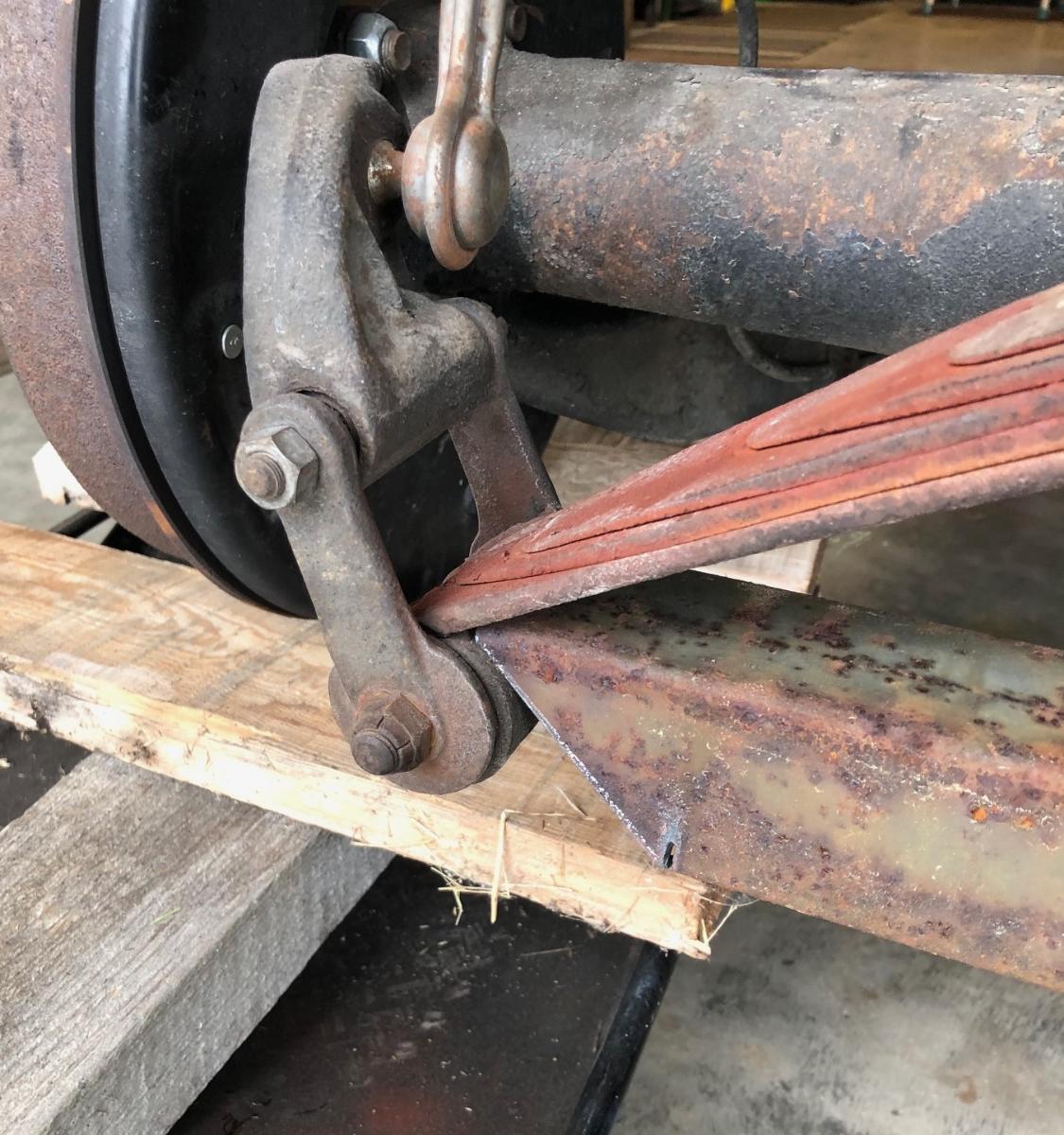

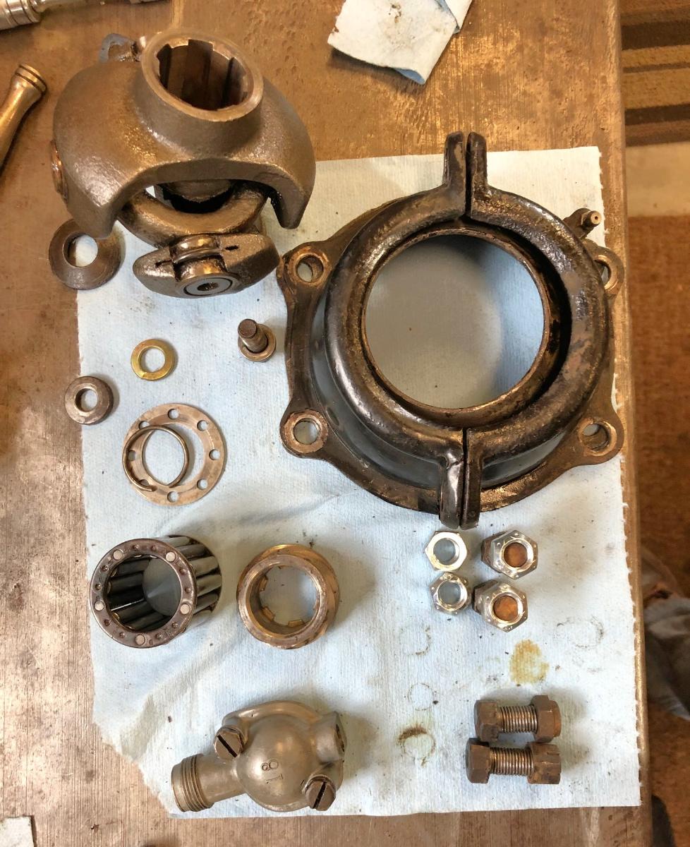

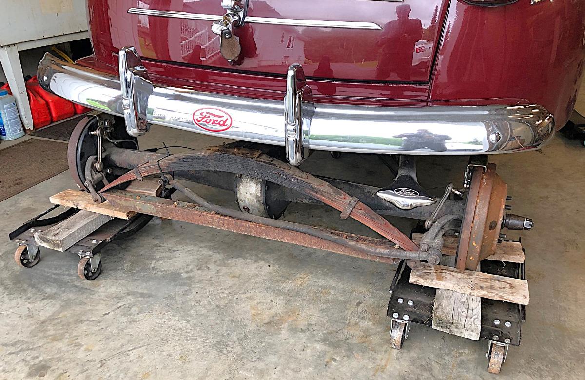

Here is an excerpt from an article I submitted to the Southern Ontario EFV8 Newsletter, about removing the rear axle/torque tube to change the torque tube center bearing on my '46 Super Deluxe Coupe.
The job started by removing the front floor mat and transmission cover, jacking and placing safety stands under the frame, removing the rear wheels, disconnecting the speedo cable, rear brake line at the torque tube, e-brake cable, shock links and sway bar. As I was doing this job by myself, I had to sit back and think about the next steps, of taking the “clamsh*ll” apart and lowering the rear axle to get it from under the car. Two things were necessary; make the assembly easy to move around, and keep the spring compressed enough to get the needed clearance under the gas tank and bumper. As in the picture, a 2”x2”x41” steel tube, mitered 45 deg. at each end, was positioned between the spring eyes before removing the weight of the car, to hold the spring from arching. A pair of wheel dollies with some blocking made it easy to move the axle/torque tube assembly around. After the spring U-bolts were removed, the clamsh*ll disassembled and the driveshaft moved back. I removed the u-joint from the back of the transmission to have a good look at it, and noted that a previous “wrench” had not used the proper dished washer on the bolt that secures the u-joint to the trans shaft. I called to have the correct washer added to my parts order. While I was in the back of the trans area, I tightened every nut and bolt I could access. Three of the eight bolts that hold the clamsh*ll housing on the back of the trans, were loose. Those bolts are only accessible when the u-joint is removed.
