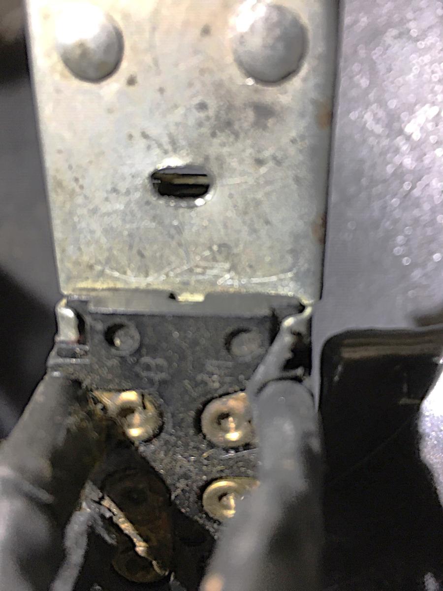

Here is a pic of the bottom side of the HL switch in my '46 Coupe. Inserts a small flat blade screwdriver, push up and pull on switch knob.

If it’s an original ‘40, it will definitely have the small hole that you need to insert a paper clip and push the internal locking tab. If you force the issue and turn it, you stand the chance of ruining the switch internally and replacements are getting difficult to find. To replace the knob, all you need to do is put the shaft back in the switch and push it forward. It will lock in place if you didn’t damage it while removing it.

At 92, I learned something new. When I was a teenager, I was told the method that I described and have been using all of these years. Today I examined a switch closely and found the hole. Barney, I apologize for giving you incorrect information.
