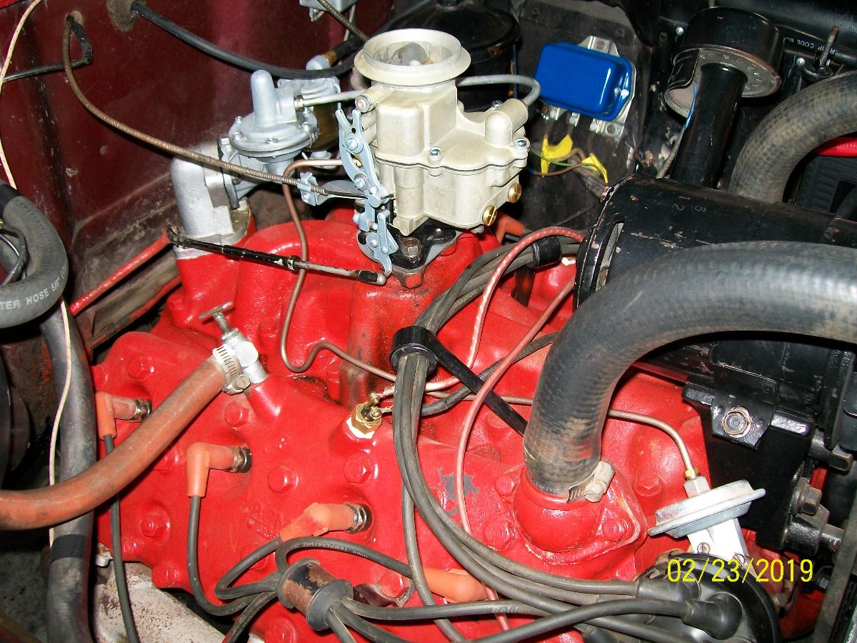

Gentlemen, Last week I drove my 1950 Ford Fordor Custom to church and back just fine. No problems. Yesterday (Sunday) was to be the same routine, a drive to church and back home, a trip of 24 miles round trip. However, my Ford would not start. It would turn over but no start. A shot of ether made no difference, it just cranked and cranked with no start. So, where do I start to trouble shoot this? Yes, the gas tank is 3/4 full. My Ford has the flathead V8 6 volt system. Good cables, good battery, no corrosion on terminals. Can a coil just die without any warning? I would think that is unlikely. Points, condenser, can they die without warning? Your good advice will be greatly appreciated. John
