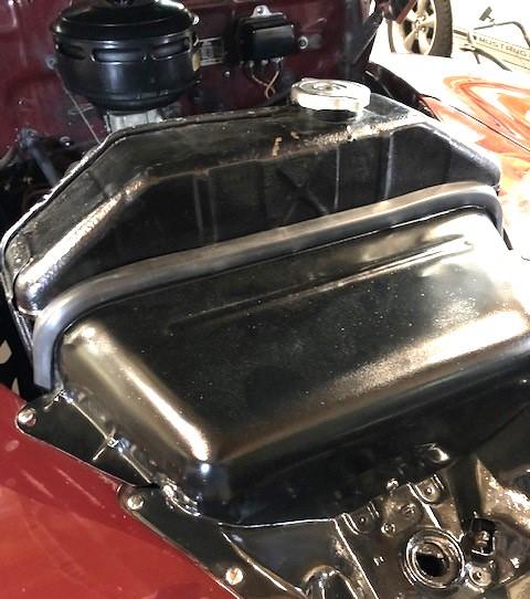

Have new pumps, new aluminum radiator, new 160 thermostats and a new 6 blade electric fan. My factory top shroud seal does not fit tight up against the new radiator. I'll get that tighter and see what happens. My thought was with the restrictive exhaust if I eliminated that and got the exhaust pipes away from the front of the engine it might run cooler. I also did the test for a bad head gasket. It was not bad. Appreciate your feedback.
