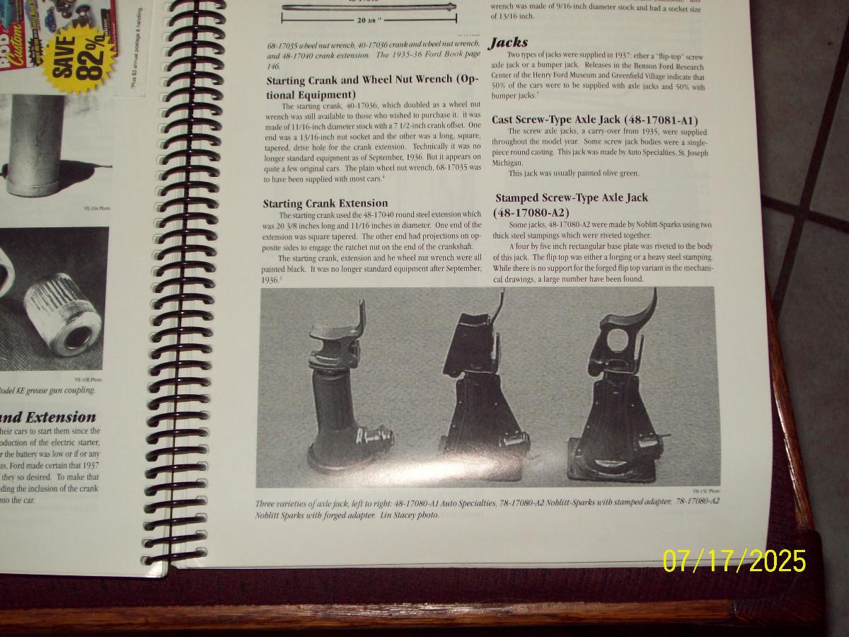

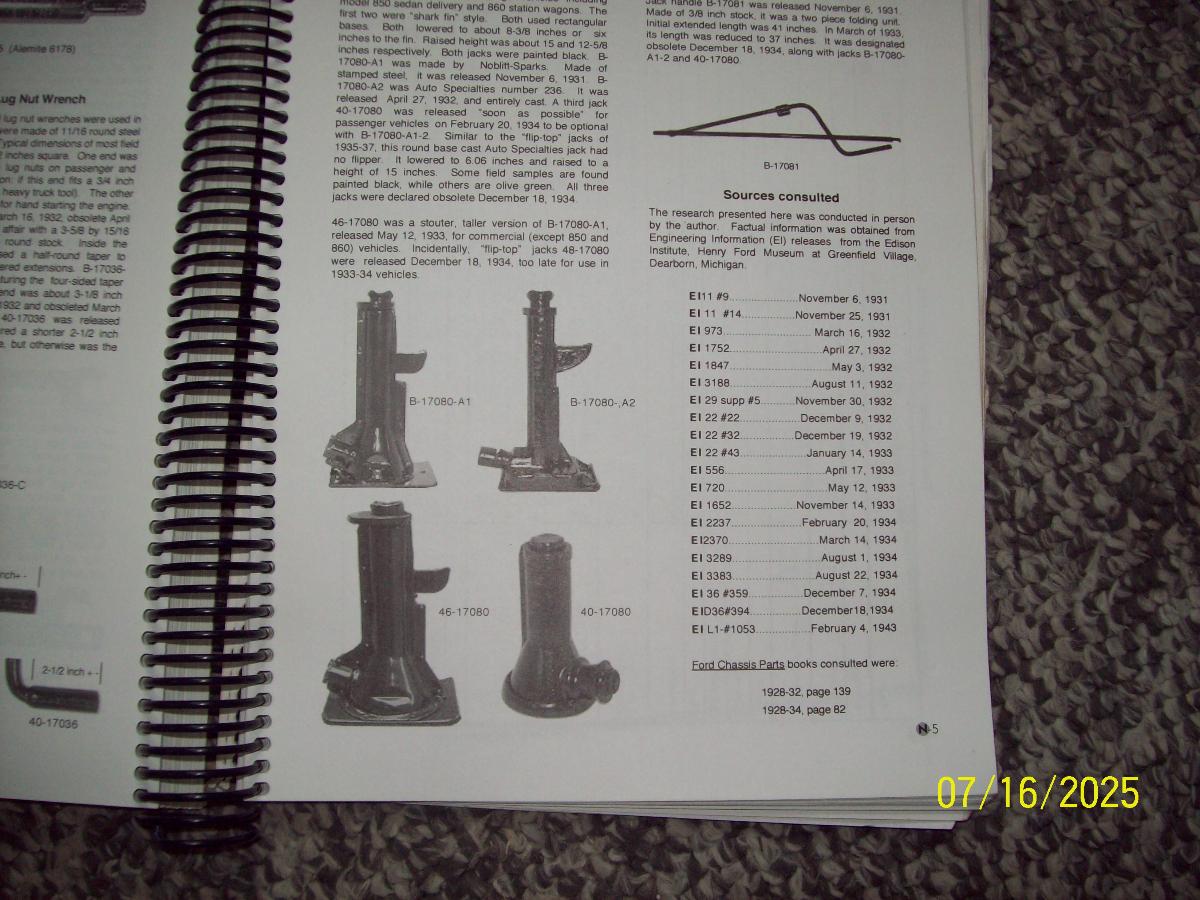

Does anyone know what the original tire jack looked like for the 1937 Ford Sedan? Could someone post a picture. Found a couple screw type jacks today at auction and hoping one might be the correct one. Thanks for any help.
juergen
07-16-2025 @ 6:38 AM
Posts: 275
Here is a picture from the clubs 37 restoration book. Sorry, this is from the 34 restoration manual.
This message was edited by juergen on 7-17-25 @ 6:34 AM
juergen
07-17-2025 @ 6:36 AM
Posts: 275
This is from the 37 restoration manual
