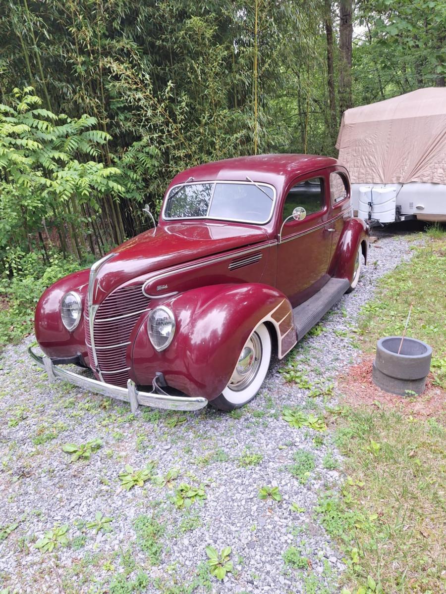

I'm a new member and an owner of a 1939 Ford Standard Tudor.
I purchased this car a few months ago, it is a survivor.
While driving home from a show in Reading PA, the shifter stuck in 2nd gear and is really jammed!
I drove it home, about 4 miles, at about 20 mph.
Where do I start?
How much of the floorboard needs to be removed for shifter access?
Does this sound like a shifter problem?
Any and all help appreciated!
Thanks!
