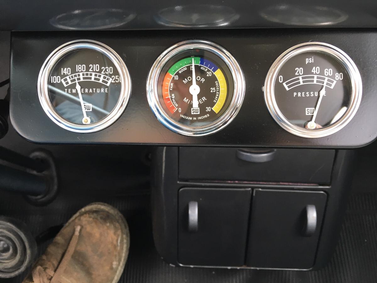

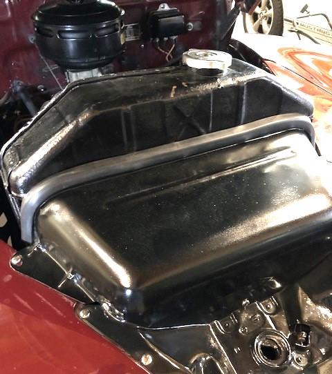

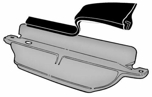

When I bought my '46 Coupe, stock 59AB and rad, it had miss matched stats (160/180) and one was cocked 45deg in the hose. Reading posts about overheating , I installed new 160s, new style pumps, a 4psi cap, and had a rad shop "descale" and pressure test the rad. After a few trips, I replaced the 160s with 180s as the engine ran to cold for my liking. One thing that I believe helps with cooling is that it has a six blade fan, which may not be what came out of the factory. In talking with others, some causes of overheating, other than those listed in above responses, is missing top or bottom shrouds and or shroud seals. Recently did a three hour run in 80deg at 65-70 mph, and temp held at 180deg. with stock gauge sitting at mid point. City/town driving might get the temp to 185deg.
Temp shows lower than actual reading due to camera angle.
