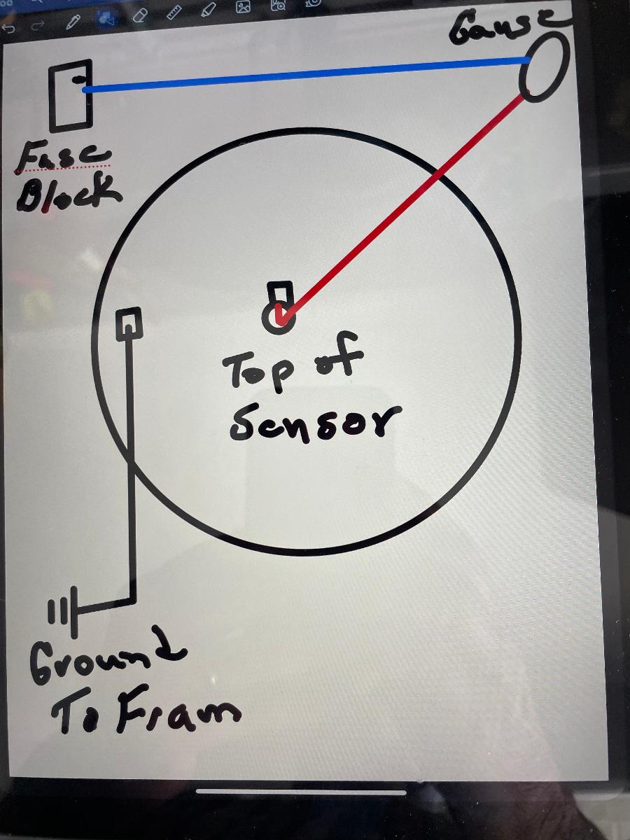

Attached a visual showing how I have it wired now. Blown fuse is at the fuse block. Six circuit block with no troubles with other circuits. Ground wire is attached to spade terminal which was how sender came out of box. Sender to gauge wire is attached to a threaded bolt which was there out of the box. Gauge is original gauge which was working before replacement parts. Thanks to everyone again

Understand now that all you have done electricly is the new sender. And appears to me you have it wired correctly.
At this point I would start isolating: Remove sender wire from gauge and see what happens. If now ok (fuse does not blow), tells you problem is in the sender sub-circuit as you are suspecting. Re-connect to gauge and remove wire from sender. If now still ok, tells you wire is ok. Re-connect to sender. If now still blows the fuse, tells you short must be in the sender itself.
