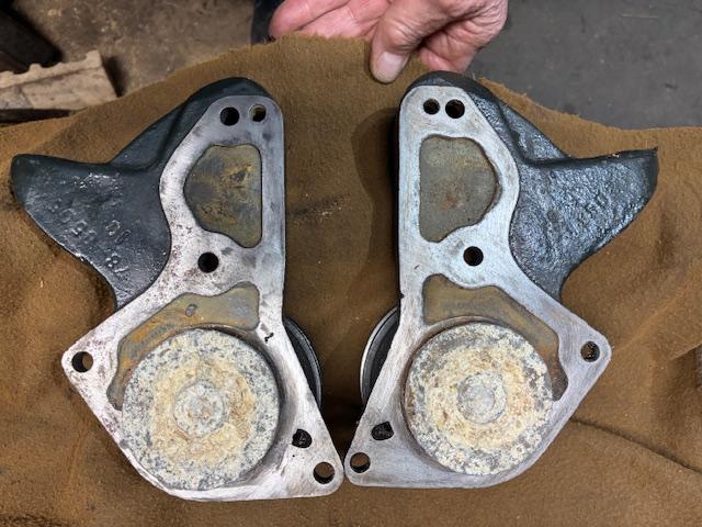

I removed both pumps and found a built up a white powder cake on the impellers

I used a endoscope in the top of radiator ,that also has the white cake,soon as I get a chance I am going run cleaners though the cooling system and take photos to see what it looks like cleaned,
with the radiator hoses off the heads, does not seem to
have the white cake ?
will let you know what I FIND out,
