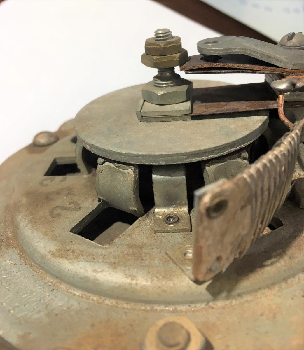

How do you repair horns. They click but do not honk.

try this,
did you remove the horn covers and clean the points,
also make sure your wiring contacts are clean and tight,
I would use a seperate wire directly from the battery to the horn, using a jumper lead for the hot wire
and another jumper lead for the ground, directly to a good ground,
and see if this makes a difference,
if it does it could be the horn relay , or a wiring problem
go over the system with a volt meter, and see if youhave enough voltage,,
did you try it with thw motor running, does you generator put out enought volts, like 7 plus
I would use 320 wet and dry emery paper to clean the points, on the horns,
hope this helps,

04-16-2025 @ 6:37 AM
Posts: 563
