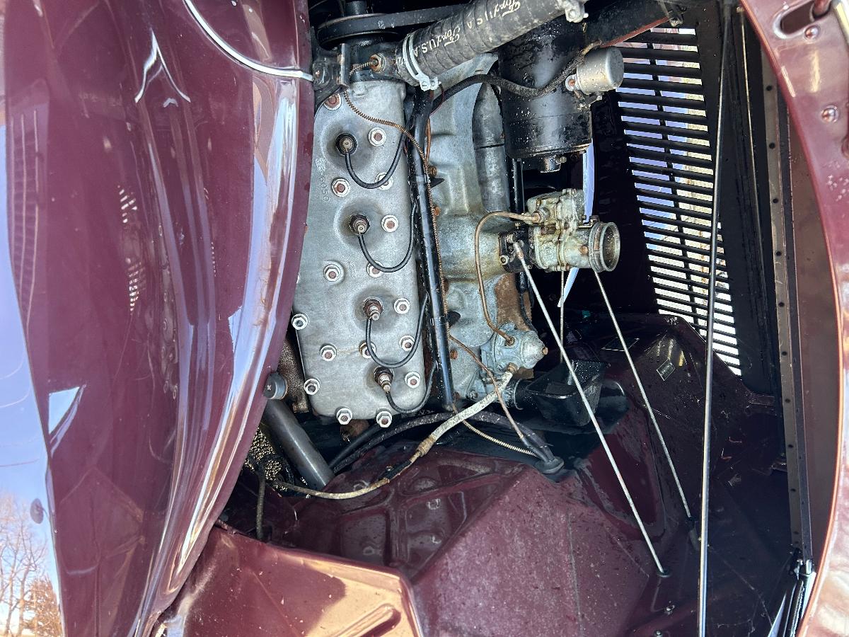

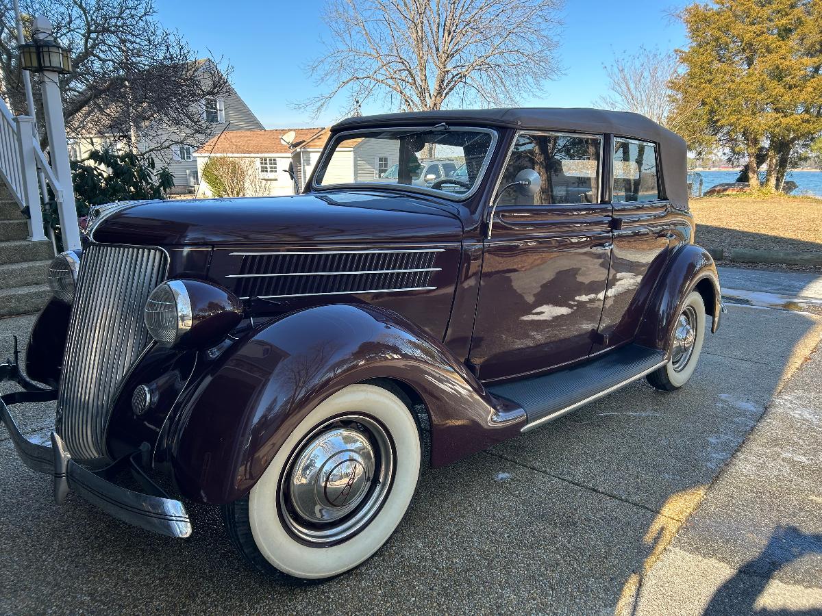

Hello all,
I recently began working on a 36 Sedan Conv. It was originally my Grandfathers (S.L. Ross) car restored in the early 80's. He showed it extensively and was awarded a Dearborn award, among others. He conveyed to me that he regretted showing it so much and not driving it.
I am going to make it a driver car. I don't want to destroy that quality, but do want it reliable and fun to drive.
Currently the radiator is a mess, weeping everywhere. I wondered if there was any advice about a replacement/more effective radiator. I understand that the 21 stud flatheads can run warm. My intent is to store the original radiator in the event that I want the car back to stock.
Are there any modifications that the group would recommend to make it a great driver?
Any carb, gearing, brake modification, 12v conversion advice would be appreciated?
