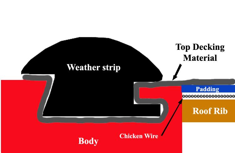

Ten years ago when I installed a top on a 35 coupe I had the original tack strip but needed the rubber filler strip. The strip was a round rubber (I think) not the stuff they are selling today. Are they not making the round rubber or am I mistaken.

The roof insert rubber was not round. Attached is a picture of the roof insert rubber from former 36 Ford Advisor Don Rogers and now the 35 Ford Advisor
