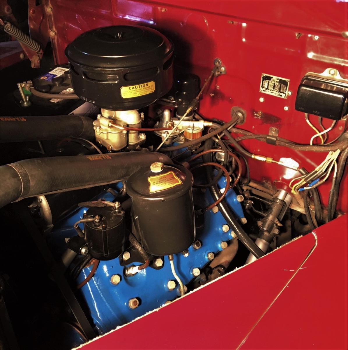

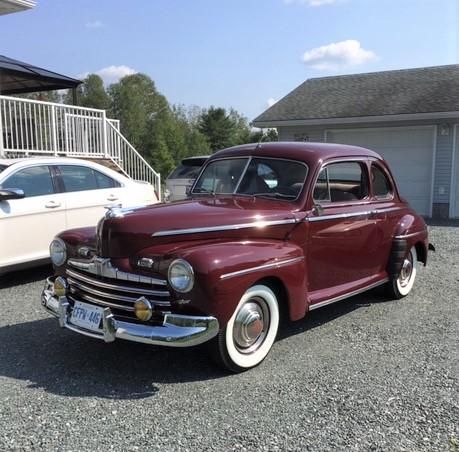

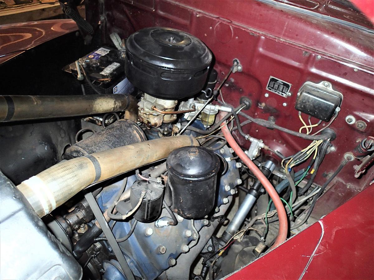

When I bought my '46 Super Deluxe Coupe eight years ago, the seller was concerned that I would hotrod it. The car was pretty much original and in good condition, other than issues that come up from sitting unused for a number of years. I had thoughts of "upgrading" the brakes, changing to electronic ignition and converting to 12 volt neg. ground. none of that happened. I became a member of the EFV8 Club, bought the 1941-48 Ford book that the Club publishes, as well as service and parts manuals from various suppliers. Having a mechanical background helped me to do the work I needed, to make the car a reliable ride. I replace the brake shoes and wheel cylinders, tires, water pumps and motor mounts, rebuilt the carb, fuel pump and distributor. Some of the work was challenging, but it gave me the knowledge and confidence I needed to enjoy the car, knowing that it would be reliable and that I could fix it if needed. I drive it 2000-3000 miles per year, and it always brings me home.
P.S. I cheated and installed a 6V + ground Powermaster alternator.
