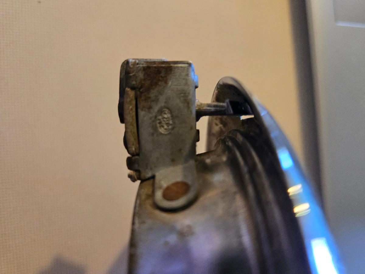

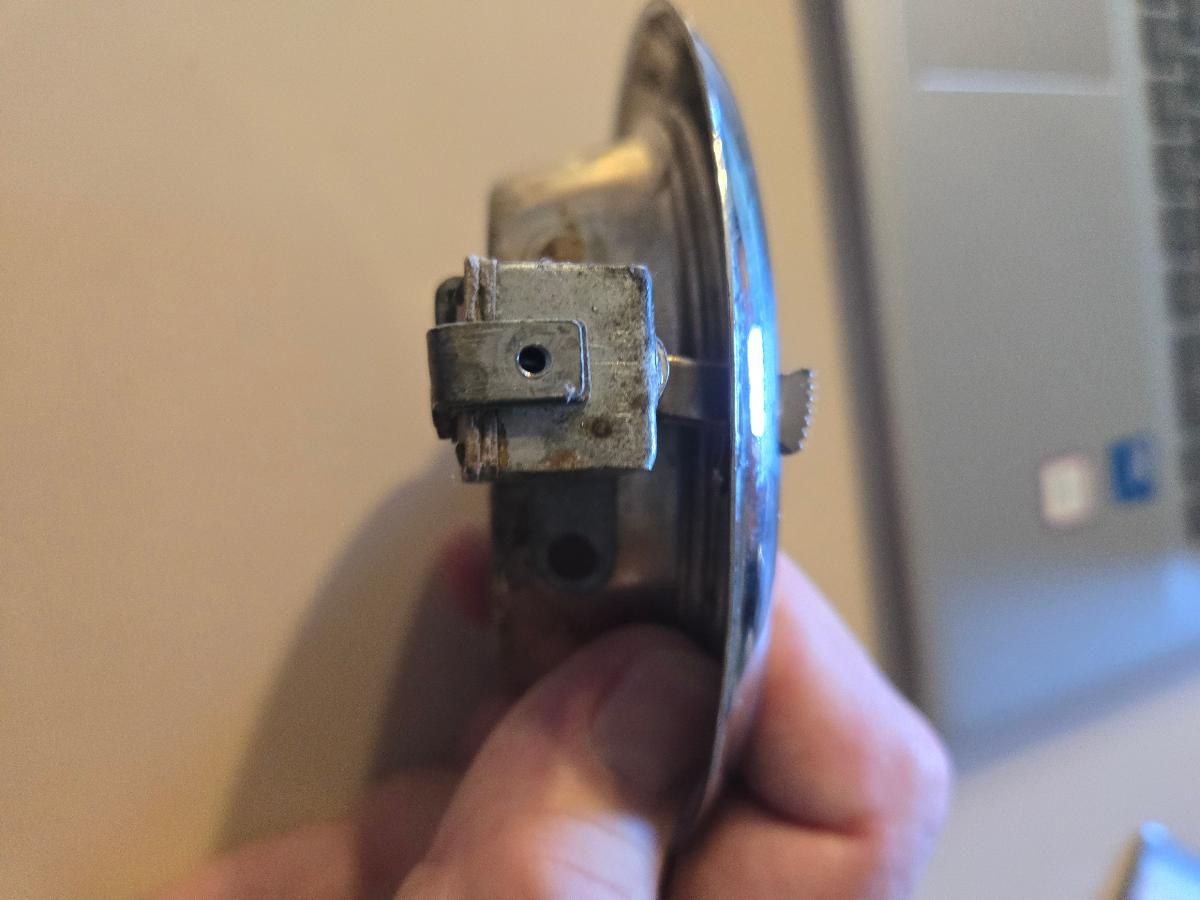

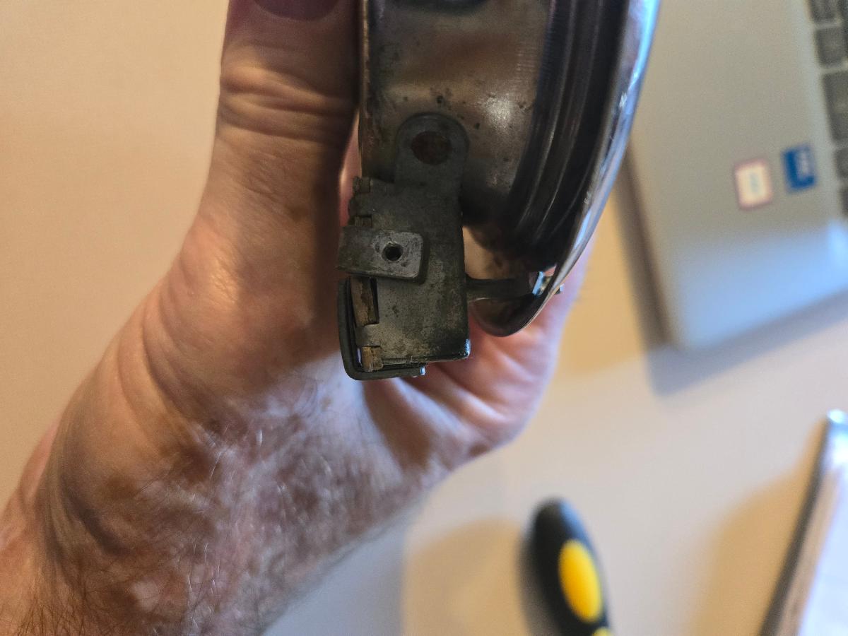

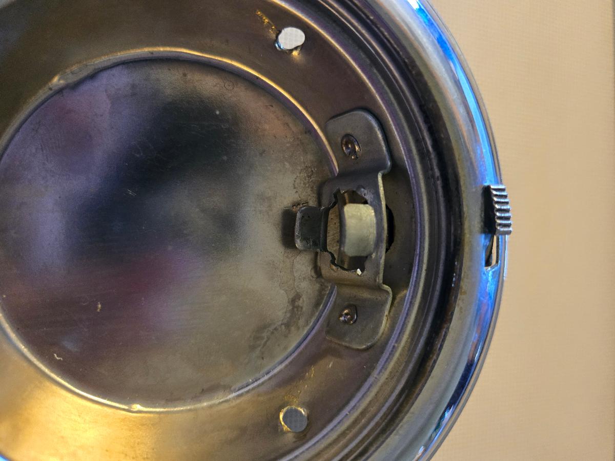

Switch does not work. Any know if these can be fixed to Period Correct & who might do it? Anyone have a Period Correct Used one for sale?

It looks like that switch can be opened up and the contacts cleaned to make it work again. There may be a small spring inside, so be careful when you open it. You want to be able to see how the parts are arranged before you try to clean it.
