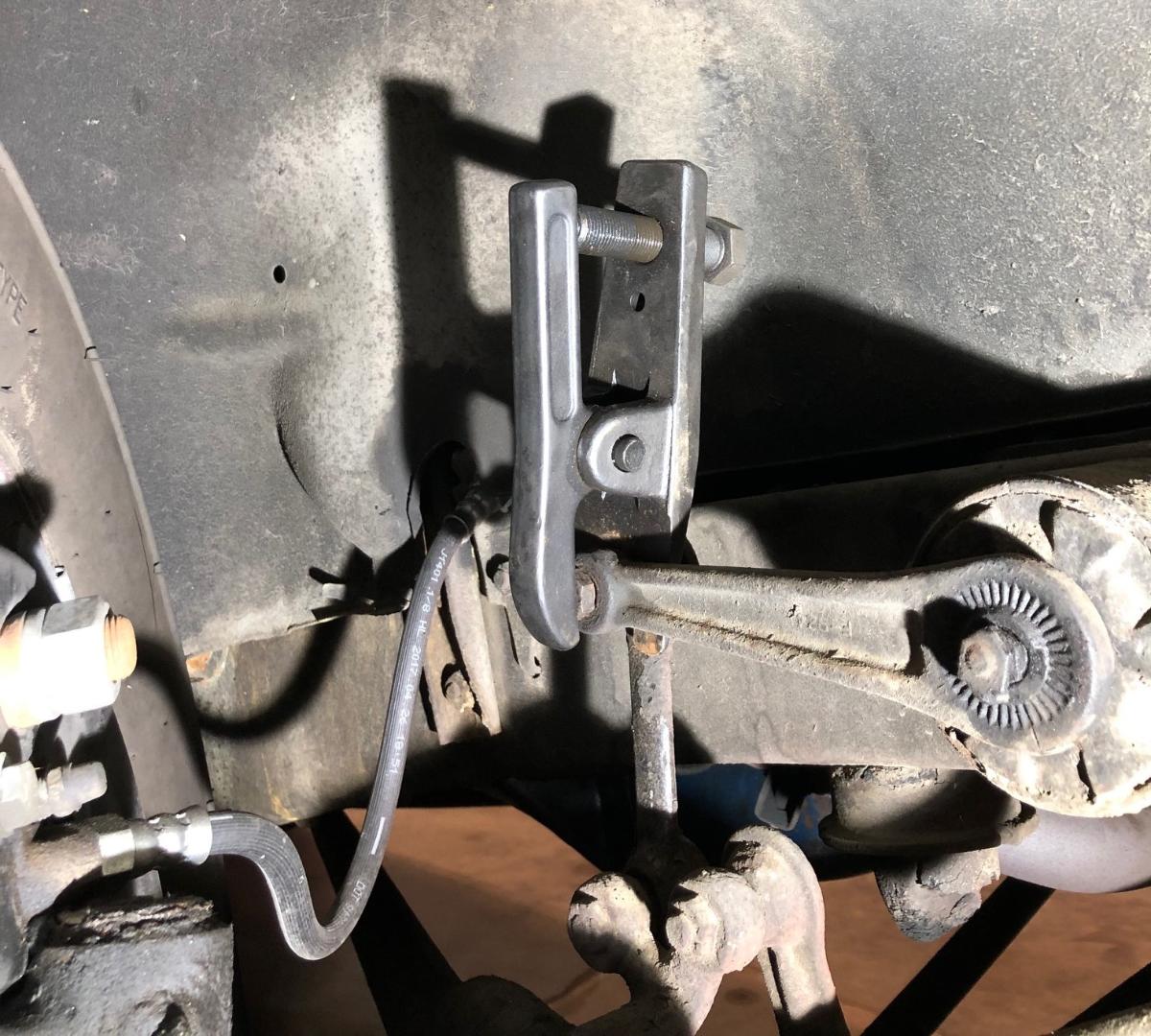

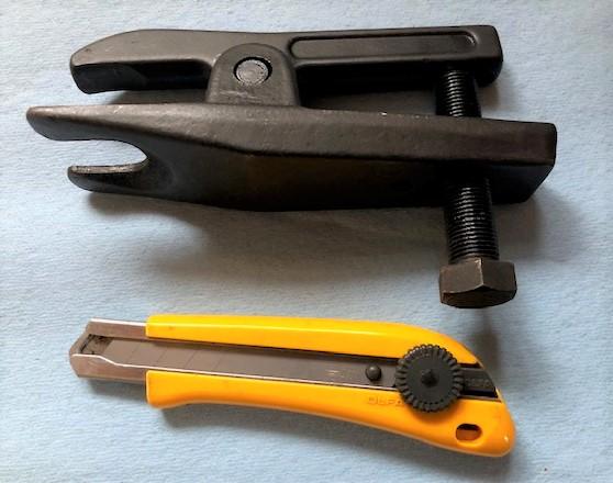

51woodie
09-29-2024 @ 7:21 AM
I use a tool that I got from my local auto part store, and it works very well. Check with Harbor Freight. Back the nut off until it is flush with the end of the threads, put the tool on, and tighten the jack bolt until it breaks free. The tough ones sometimes need a smack with a hammer on the head of the jack bolt.
