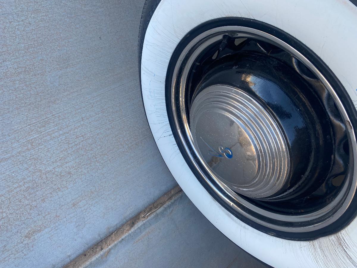

1939 Ford- deep dish hubcaps- because the spring steel clips being slightly bent I will have a hubcap come off and roll down the road. Several clips are missing as well. I am concerned about heating them and bending back. Maybe super glue shims to tighten connections?? Would appreciate thoughts on this.

Drake has these replacements
https://bobdrake.com/products/1936-39-car-pu-1939-47-com-wheel-spider-clips?_pos=1&_sid=7a1fe9838&_ss=r

I had a 1936 with the same issue. First make sure you have all 5 clips present. I also put a few dabs of rtv around the edge of the hubcaps just as added insurance.

I used these on my 1936 Ford sedan and they work well. I lost a hubcap as well. This should fix the problem.
