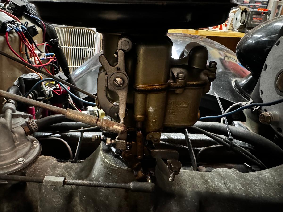

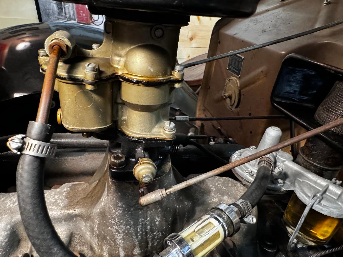

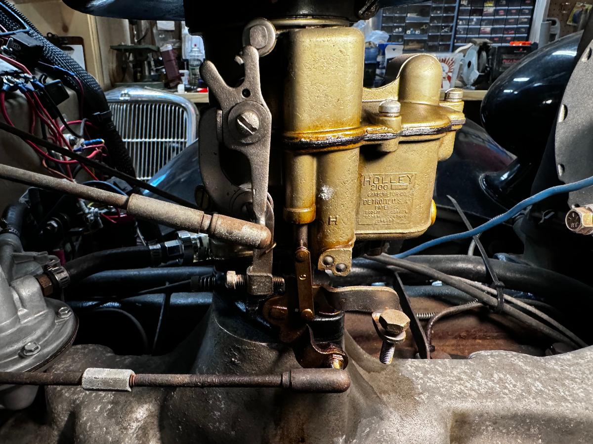

My car has a Holley 2100. I thought it was correct but maybe not. Of course nobody has a rebuilt Holley 2100. What do yall recommend?

There is gas present around gasket on side facing right fender. Could I just bolt a Stromberg 48 and be good to go?
