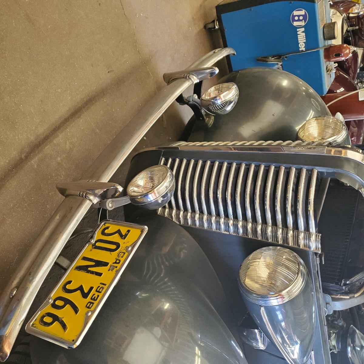

I have BLC (Guide) 5.5" sealed beam clear driving lights on several of my vintage 6v vehicles... They work great and look great on vintage vehicles. I wired them up utilizing a 6v relay therefore the driving lights do not draw a lot of amps from the 6v system.
I have 6v sealed beam headlights on my '36 that are wired up via a 6v relay therefore the lights do not put an unnecessary load on lighting system switches, etc.
Please excuse the 38 Buick pix, it was the only handy pix I had of BLC driving lights on a vintage car.
