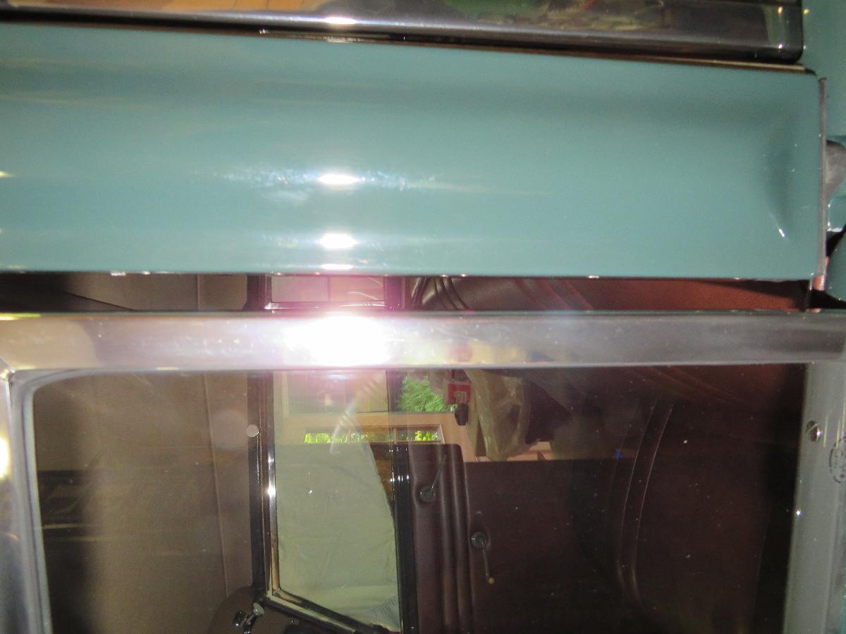

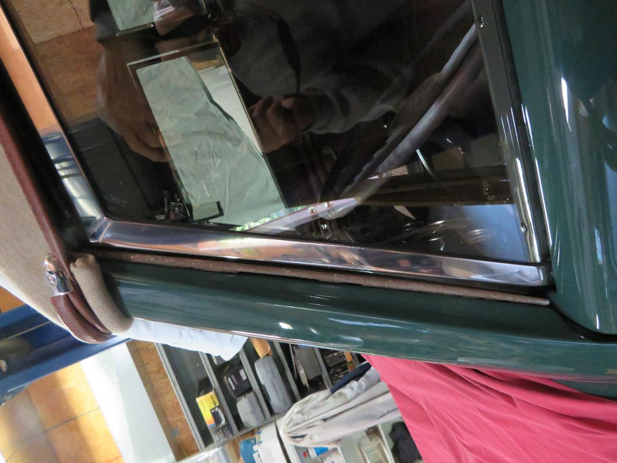

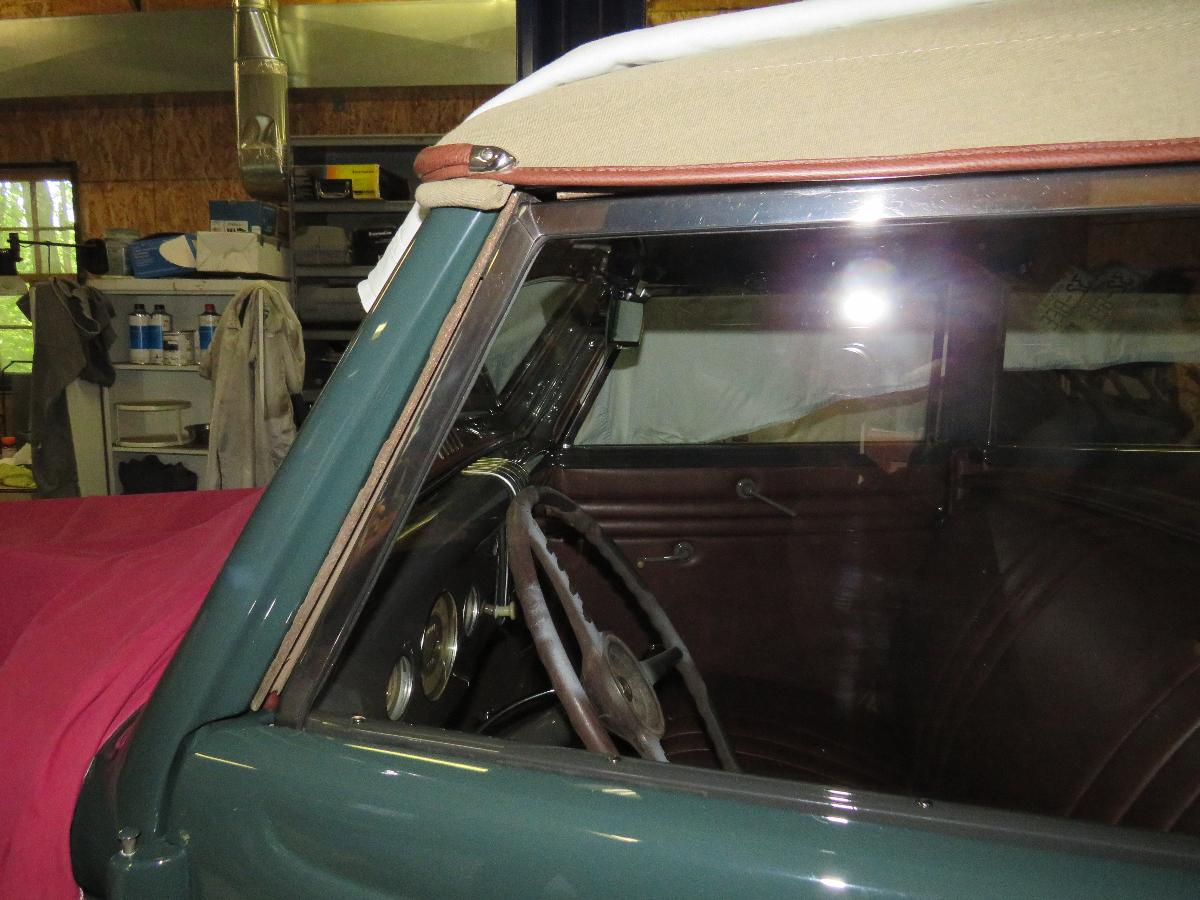

I'm trying to find out if there is any kind of adjustment that can be made to the driver door stainless
window frame in order to produce a better fit in the opening when in the rolled up position. It's like the
frame is out of plumb which causes it to almost come into contact with the special metal slot that holds
the rubber weather strip but at the bottom left side there's a 3/8" gap. I've enclosed several pictures

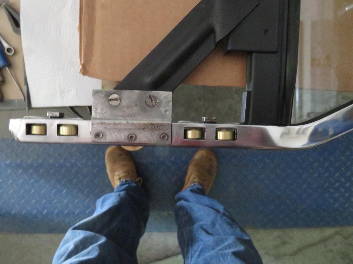

showing what I'm referencing and also a picture of one of my front frames when I had it removed from my
car. My main question is what is the main function of the spring loaded large rollers which are on the bottom of each side of the front door glass frames? Are they there to provide any type of frame adjustment
within the opening? Any help with this will be greatly appreciated as I want to start installing the new metal
slot pieces which hold the rubber weather strips.

Make sure you have the correct window regulator. Do both sides of the car have the same problem?
