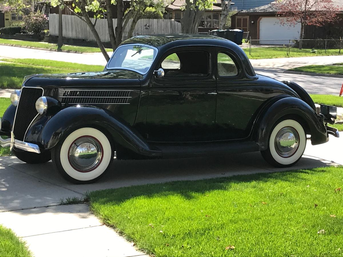

A side bar to my earlier contribution: It is not my intent to be picky about your car, it is a grate looking car, I am just trying to help you understand what you have.

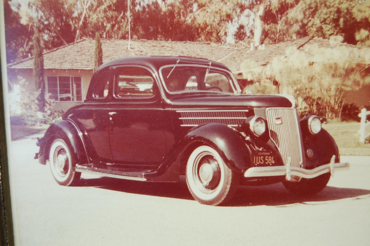

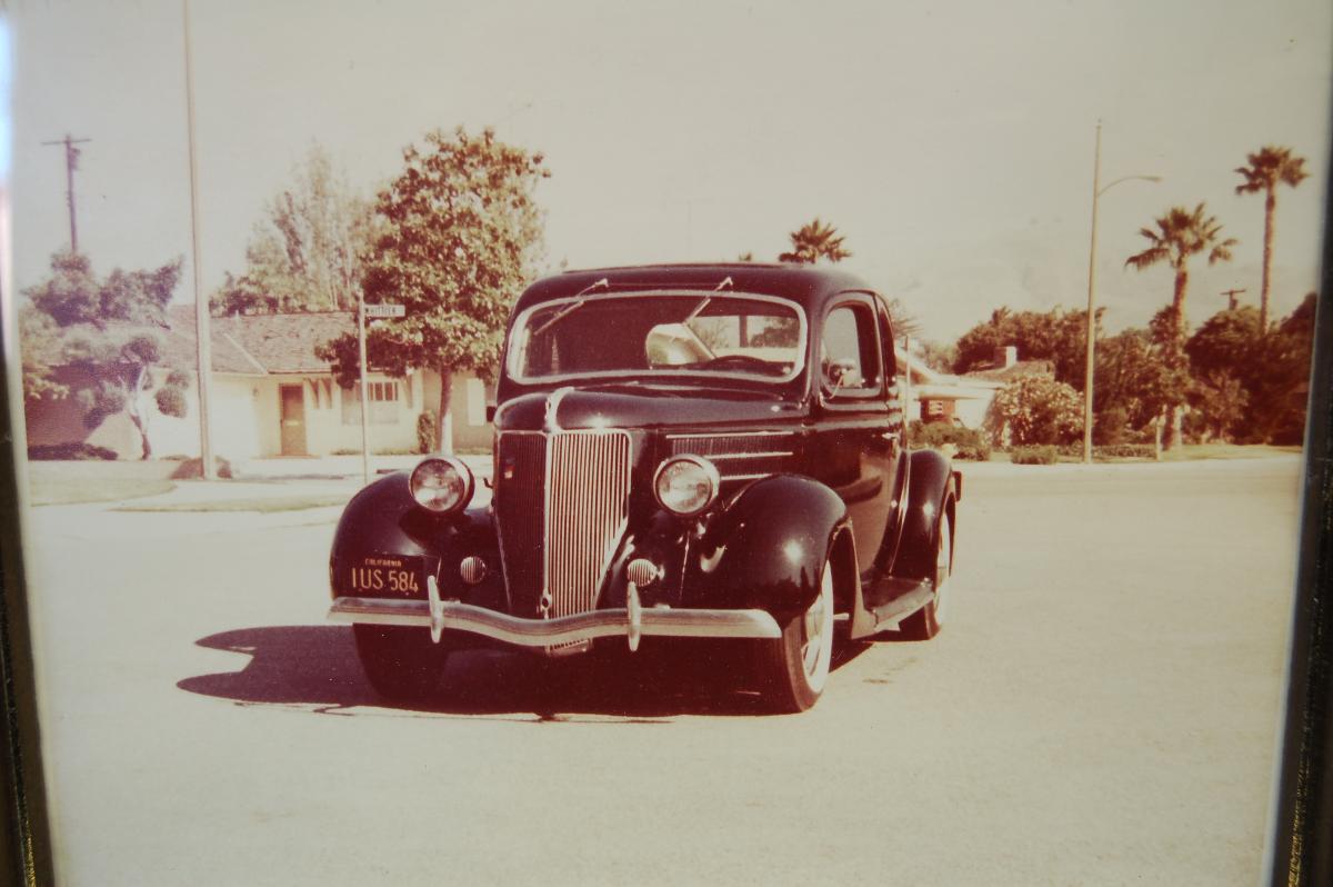

I have attached a couple of pix of my car, which I have owned for 72 years, bought it from the original owner in September 1952.
Your car is an early car, it has straight door handles similar to a '35, In January of '36 Ford went to a rounded handle which carried through '37.
The horn grilles on the front fenders appear to be painted body color in lieu of stainless steel.
I would suggest that you purchase the 1935-36 Ford Book from the EFV8 Club. This book won't help you with repairs, but it will show you what things are supposed to look like.
My car has been upgraded extensively with later model mechanical parts to keep the car running and make it more user friendly, however. it has pnly been repainted once, in 1962 , all of the upholstery, trim and accessories are original to the car.

Judy; I would suggest that you add a couple of pix of the engine compartment.
You have a very nice looking car, however. the hub caps and trim rings tell me the car has been modified to some degree.
A painted grille with a chrome windshield frame tells me that the car is not stock.
