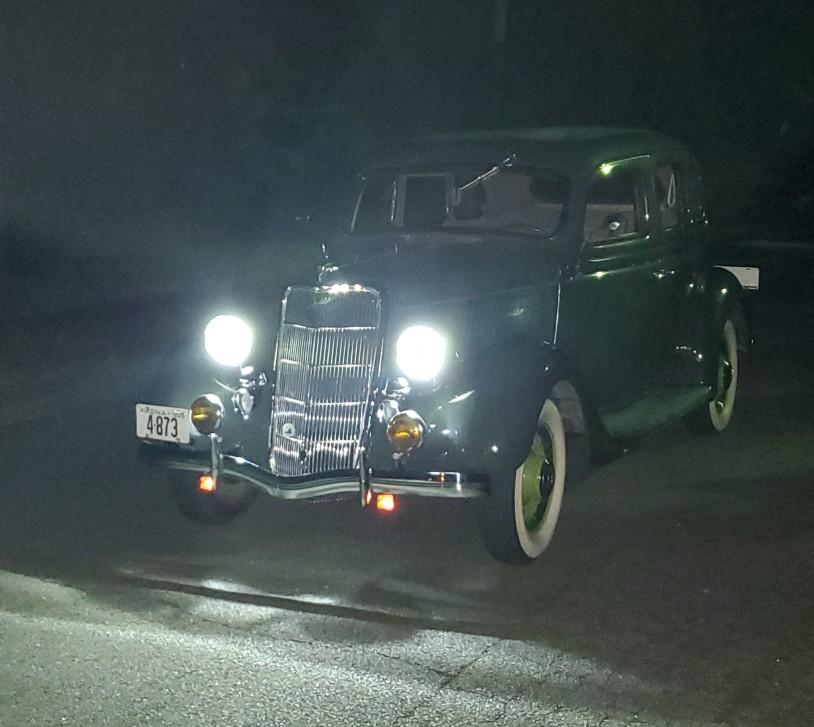

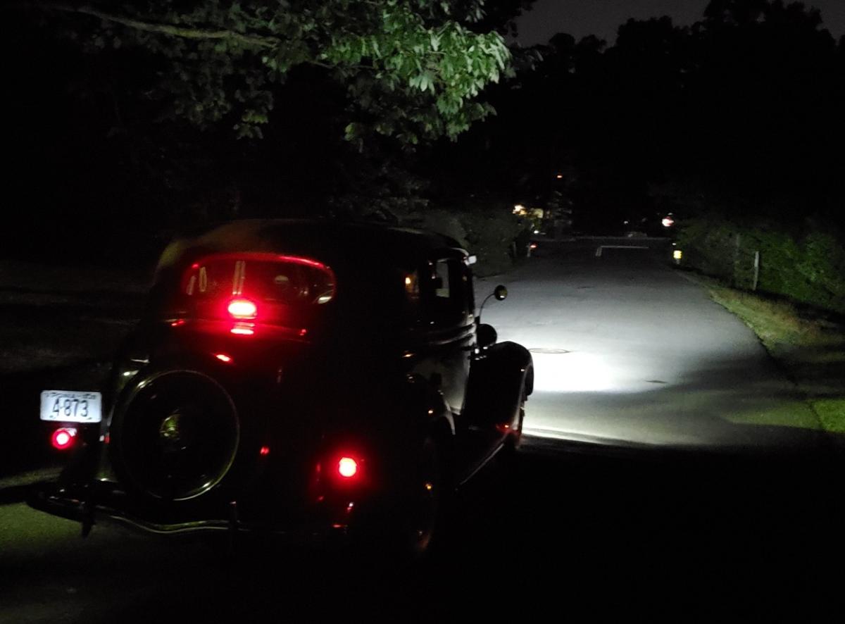

Installed LED head and tail light bulbs in my '35. Original 6v positive ground generator.
I recently installed an internal Electronic Voltage Regulator (EVR) in the generator, but with LED lights the load is very small, so the EVR is not really necessary. Before the EVR, I had the 3rd brush adjusted very low, yet it still provided a slight positive charge with the lights on.

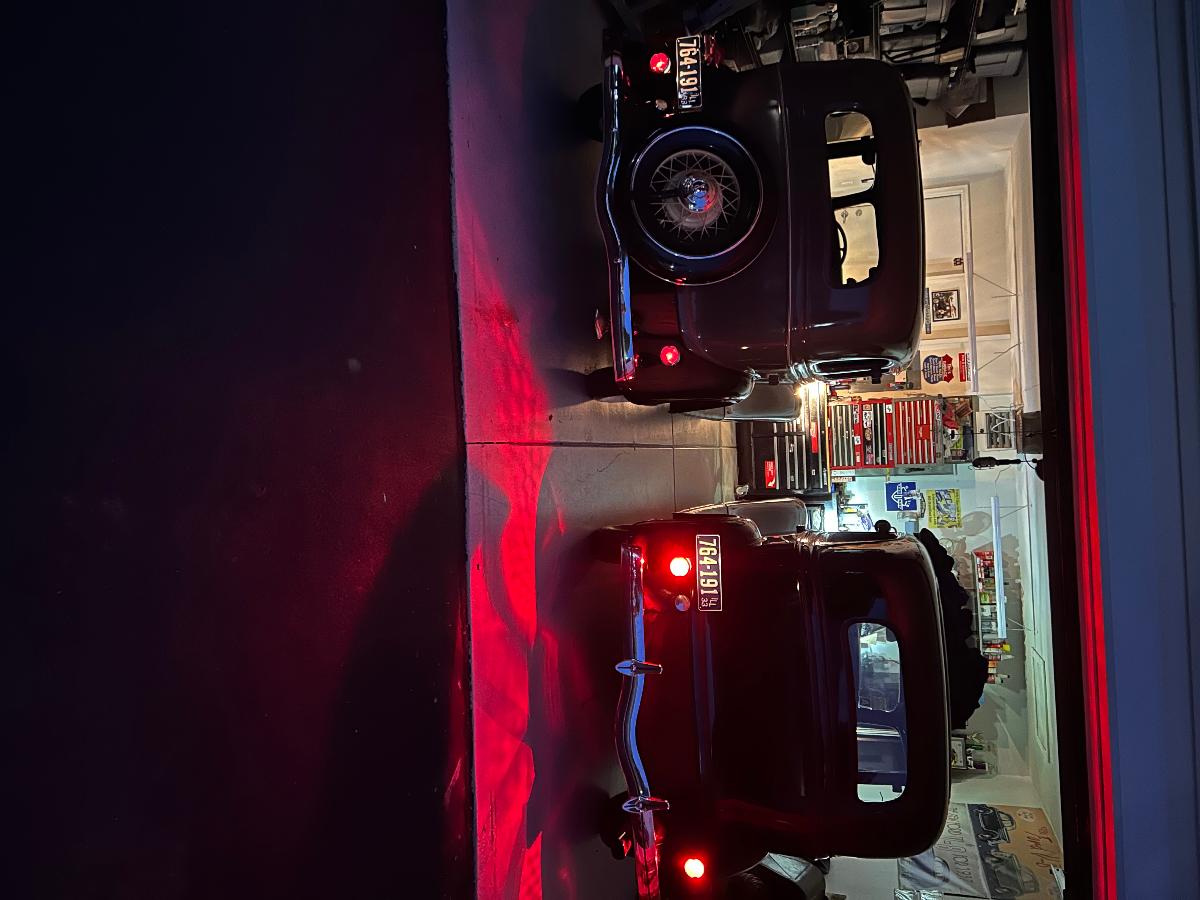

dean333
04-24-2024 @ 6:41 PM
Posts: 285
Joined: May 2012

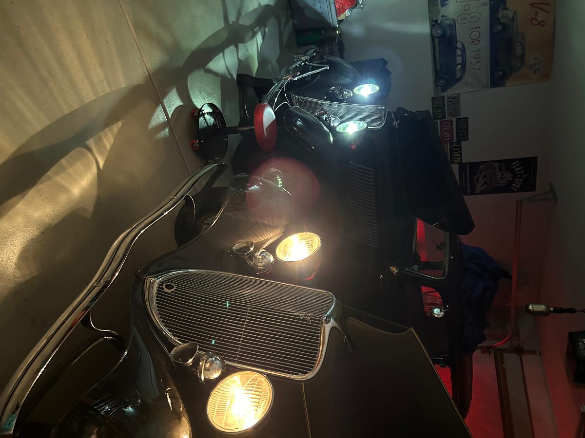

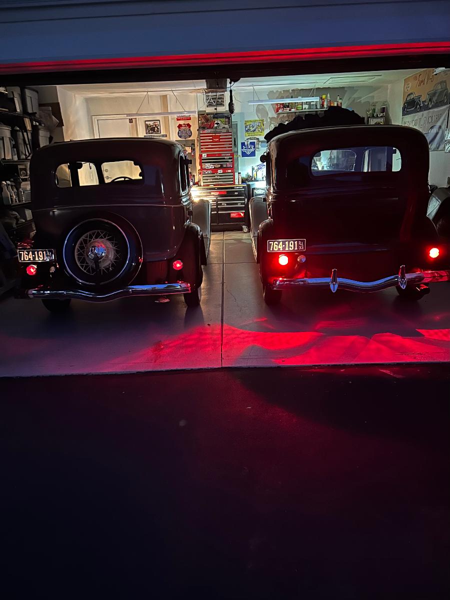

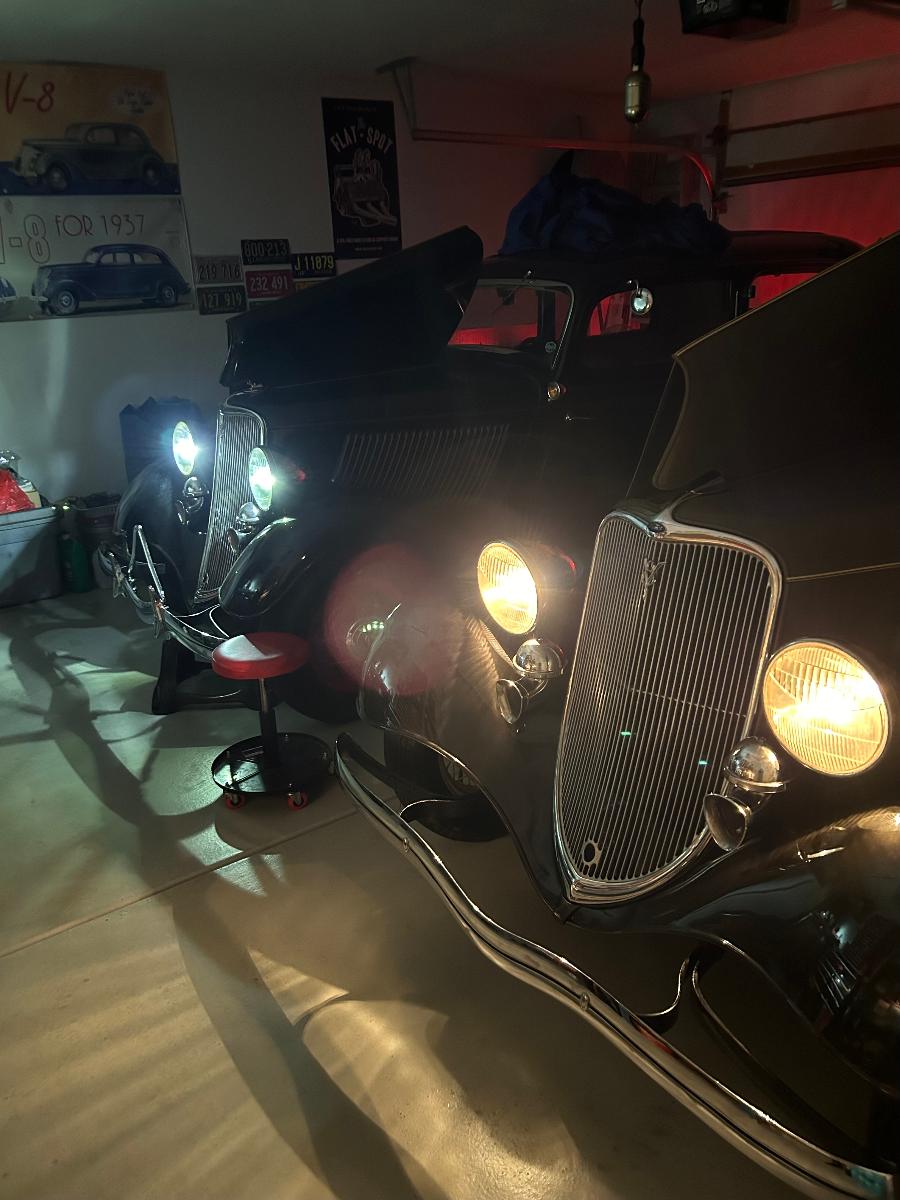

LED bulbs made an amazing difference on my ‘33
I reposted the pictures upright four posts down.
