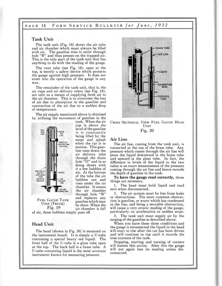

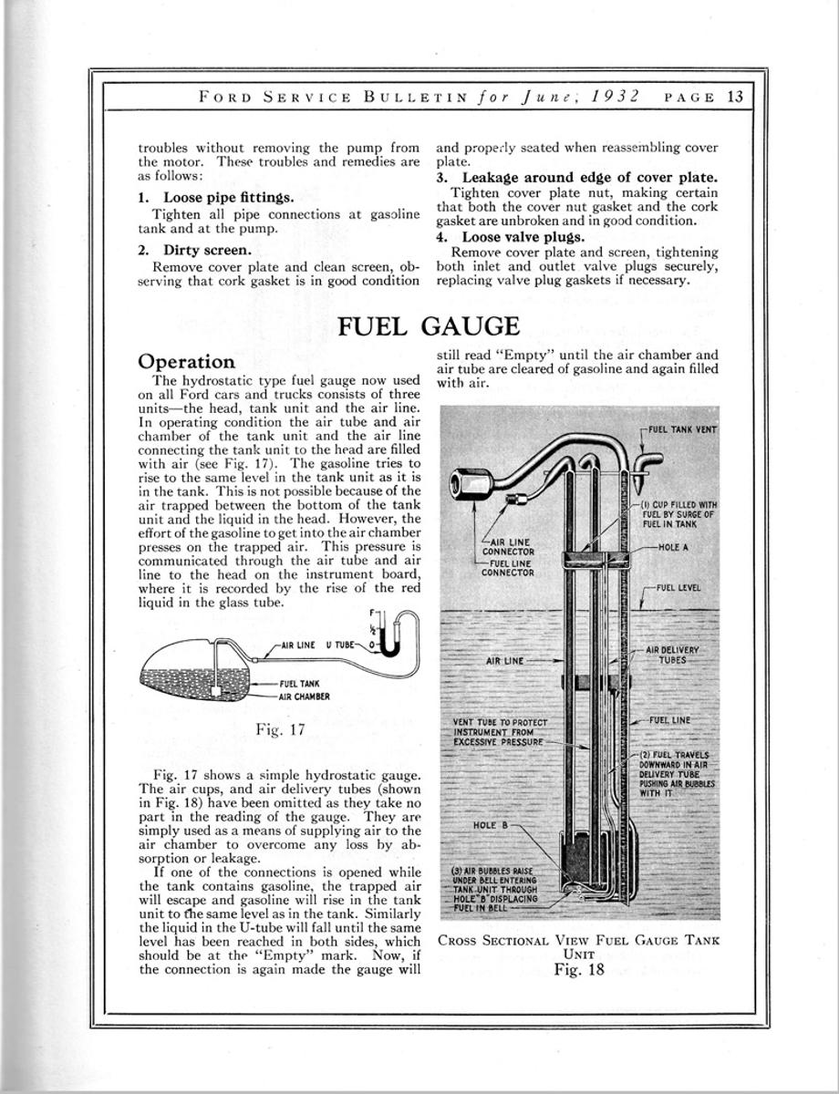

Here is what's in the Ford Service Bulletin 1932-1937 For some reason the first page is on the RIGHT, the second page is on the LEFT:
