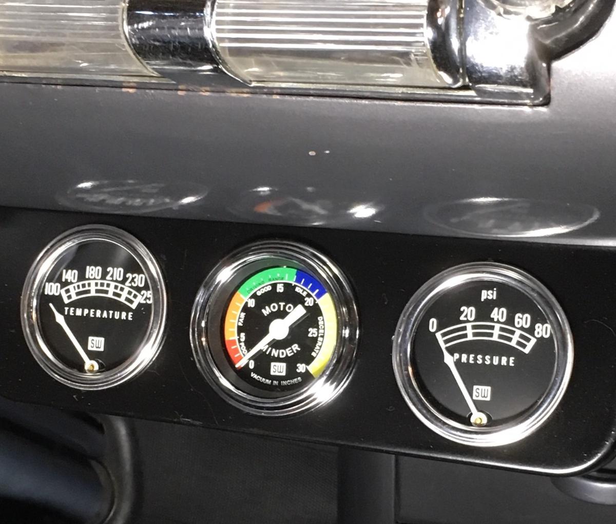

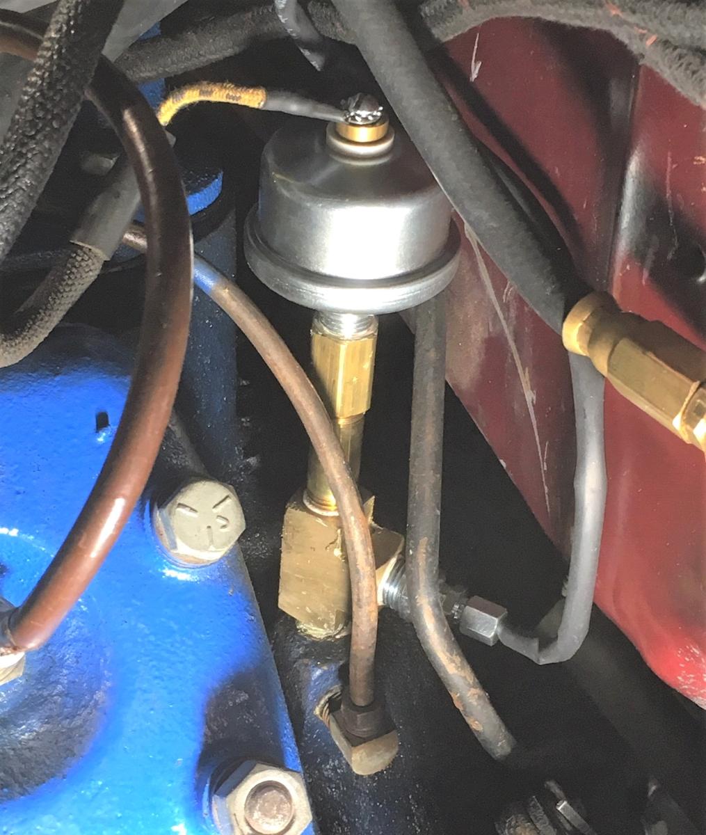

It would help to know which type of engine you are working on, so all I can help with is the oil pressure gauge. I installed oil ,temp and vacuum gauges on the 59AB in my stock '46 Super Deluxe, as none of the gauges worked when I bought the car. I have since got the gauges working, thanks to help from members on this forum. The picture shows how I did my connections with brass pipe fittings. The reason for the long nipple just below the sender is to give clearance for the throttle linkage arm. What looks like a kink in the oil pressure line, is just in the sheathing I slid over the tubing, to prevent abrasion of the line tubing at any point between the engine and gauge.
