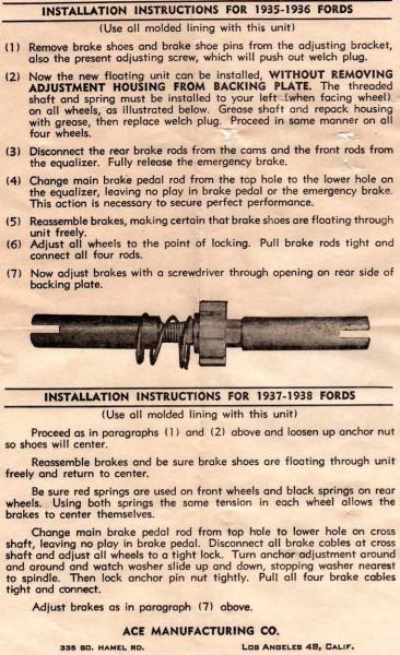

ndnchf |
04-01-2024 @ 4:53 AM
Posts: 29
Joined: Jun 2023
This may be the same or similar. I have them on my'35 Fordor and they work great.
