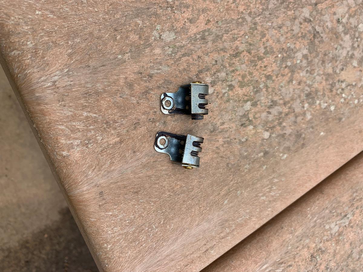

Good afternoon all.
It was the ignition resistor burnt open.
Does anyone have a recommendation for a quality USA made replacement?
This is for an all original 1938 Fordor Deluxe Ford.

03-17-2024 @ 9:00 AM
Posts: 1801
The resistor does get very hot but unusual to see one burned in half. Suggest you check the resistance of the ignition circuit to see if there is a short in the circuit before burning another resistor. The ignition circuit does not have a fuse.
