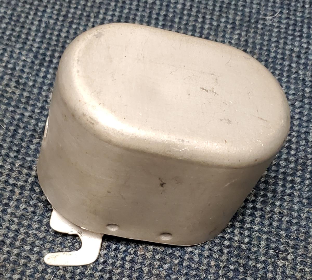

Hi Guys, I am seeking info to change a regulator, so I can use the car radio. I believe ford recommends an oval shaped unit with number 68-105050. Does anyone have a working one to sell? Or is there an electronic one on the market. Many Thanks, Metalart.

The new V8 Times has a great artucle on cutouts and the optional two-rate regulator (oval shape). They are scarce as hen's teeth. I have one that eventually will go on my deluxe '35 Fordor.
