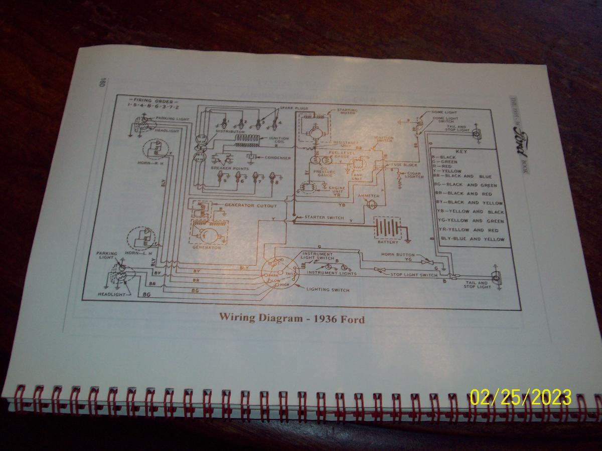

Never do wiring on a car with the battery connected! The sparks are from the horns trying to sound due to a second problem. If you can get to the horns you can disconnect the second wire on each. Hard to tell from the wiring diagram but it appears to be Black/Yellow wire. Then with the battery disconnected move the Y wire on the foot starter switch. Reconnect the battery and the horns should not sound. If the horns do not sound reconnect the B/Y wires on both horns.

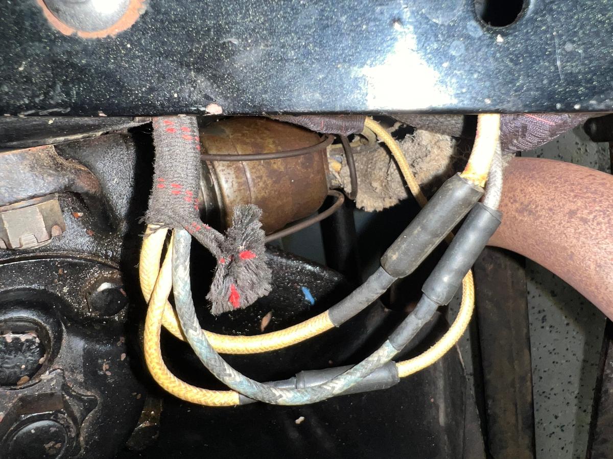

I just double checked and ther3cwasca yellow wire that was attached to the post that did NOT go to the battery. So I removed that wire and attempted to move it to the post with the other yellow wire and the wire that goes to that battery. When I touched the wire to the post, sparks flew

That's not what I see in that earlier pic. I see two yellow wires (sharing one connector) on the terminal with the battery cable. The other terminal has one fat wire (coincidentally yellow), which I assume must be going to the starter.

E. From your previous picture, it looks like a yellow wire goes to each terminal of the starter switch. Both of those yellow wires should be on the same terminal as the cable that comes from the battery.

Thank you for the information. I will try what you suggested. The car had been completely restored, which included new wiring, but it sat for an unknown number of rears afterwards. I’m wondering if the yellow wire in my photo should be moved to the other post on the starter switch?
