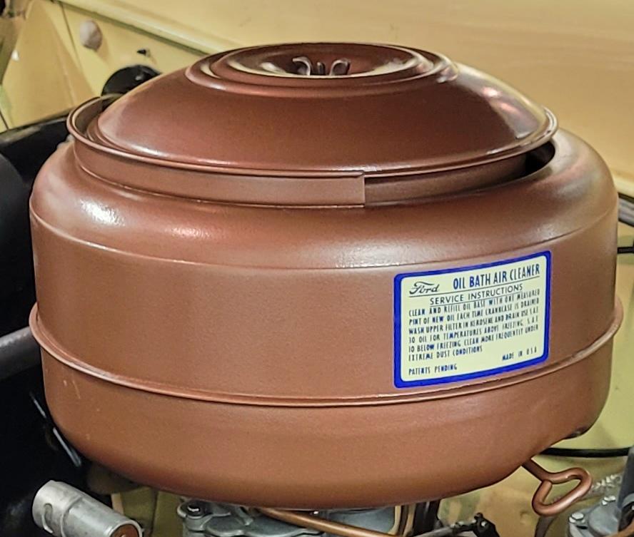

It's your car, do what you want. But sorry, personal preference. I'll stick with the stock oil-bath air cleaner that has served my car well for 74 years. Stock air cleaners should be readily available for a 1946 Ford.

i finally got to test drive the car. I installed a new air filter which isn't exactly the same as the other one. The car drove very well. Like someone suggested it looks like the engine was starving for air. Thanks to everyone for your help and suggestions. Have a great weekend and drive those V8s

I finally got some time to run some experiments. Checked the gas cap and it's ok. I had taken the air cleaner off and sprayed carb cleaner in it. On start up the engine ran rough but after about 5 minutes it cleared up and kept running without skipping or slowing down. T he the carb cleaner was used then. Well I took it on a test drive of 15 miles and it ran great. I had to stop for lights and general traffic and had no problem.
I hope this has fixed the problem. However, I' m going to keep checking the other things you all mentioned. One thing that I was going to ask, and my question was answered when someone suggested removing the air cleaner. I have the stock air cleaner but the guts of it have been removed and a regular paper air filter was installed. I have searched several places to find a replacement using the dimensions of the air filter but have not been successful. Not wanting to introduce dirt and debris into the carb, I turned the filter upside down to expose the new part of it to the air. Could this be what has caused the problem? Would anyone know what air filter might fit? I am trying hard not to have to use one of those tiny chrome things. Does anyone sell the inside "cartridge" for an oil bath air cleaner?
