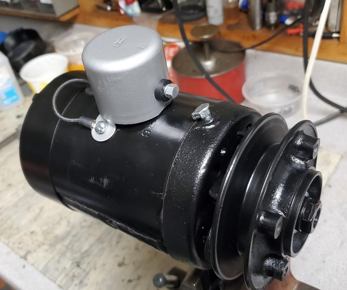

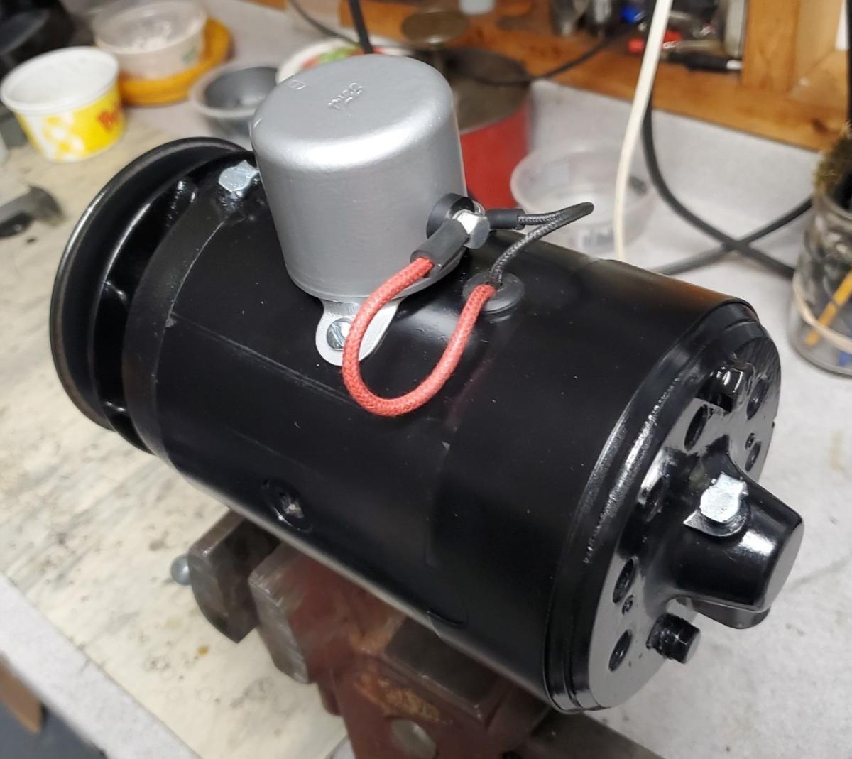

I rebuild/restore these generators and can help with yours. PM me if interested. Here is one I just finished a couple days ago.
Steve

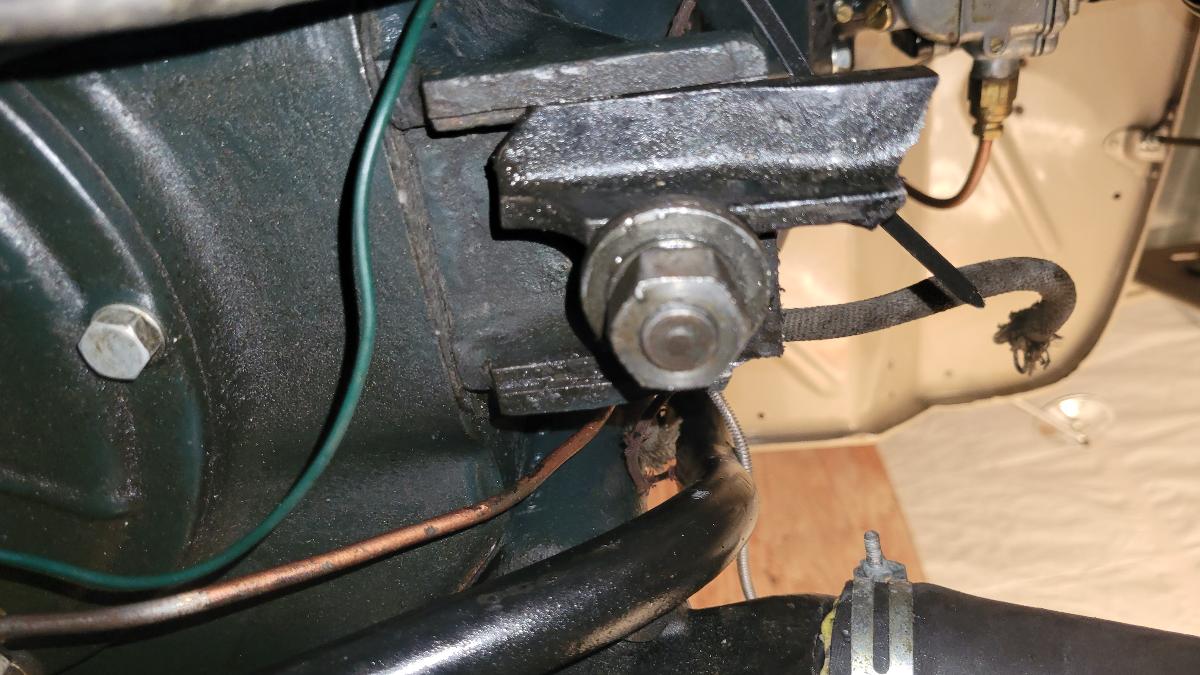

There are no replacements for the generator front bearing mount. It is extremely unusual for the generator mounting to break. They do get tossed around when off the vehicle and may have been cracked when you installed or the belt was WAY TOO tight. I don't have the proper 36 part number but it is embossed into the cast iron of the part. Look for a replacement front mounting bracket.

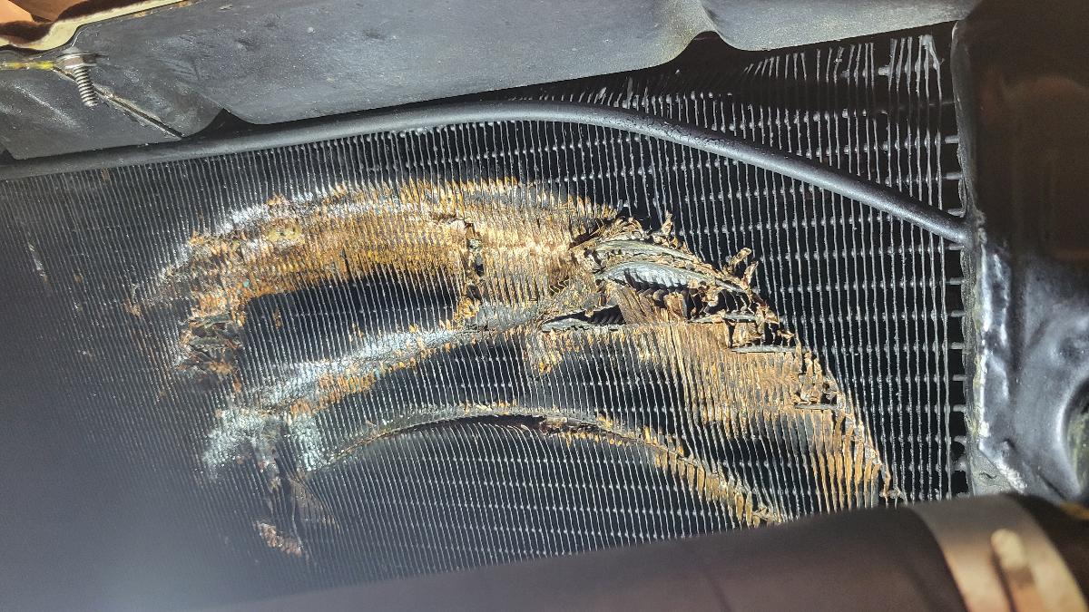

We have a good old-fashioned Radiator Repair Shop here run by an Old-Timer who's been doing such work all his life. He replaced the copper core in my radiator last year for about $700 reusing the OEM top and bottom tanks. He had trouble finding a match but got one.

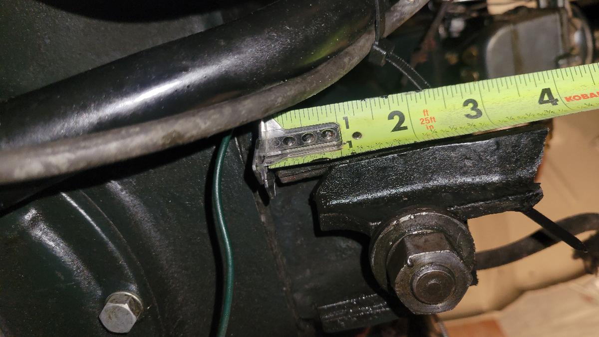

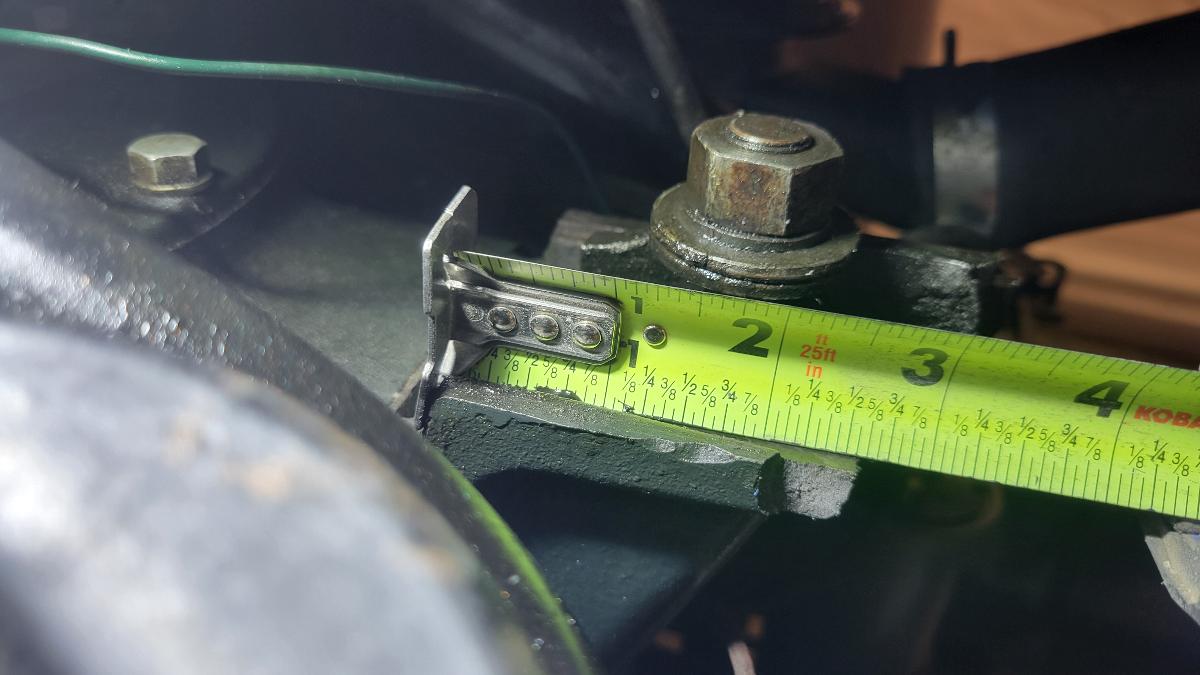

Thanks. My belts (I have several) have the correct part #, the OD is 56". The generator mount looks to be about 2-5/8" high.
I have another generator with what looks like a good mount.
From what I remember I think only 1 radiator tube is damaged. I can't work on it until the spring (working away from home for a few months).
What is the correct height of the 36 generator mount? Mine might be a 32.
In the Spring, I will get the radiator out and see if I fix the leak and straighten out some of the fins. If no I will either get it recored or try to find another one somewhere.
I try to get a shorter fan belt, and I'm also going to try to weld up a secondary support bracket, using some 1/4 or 3/8" plate front and back of the generator plate with a through bolt at the top, and piece of angle welded on the rear one, and hose clamp it around the generator.
What's the difference between the 32-36, and the 37 generator adjustment mount?

02-04-2024 @ 5:41 AM
Posts: 1801
The 33-36 intake manifold mount for the generator is taller than the later manifolds. Post some photos of your intake manifold.

Thanks for the suggestions. I'm now wondering if I have the wrong intake manifold. Are the generator mounts different (heights)? The generator it almost all the way extended (top of the range) to get the belt tight. It seems like the belt is too long, but from what I know they are all one length for the 32-36.
I think I found a place in Seattle that can recore it. However I will first try to solder up damaged tube(s).
