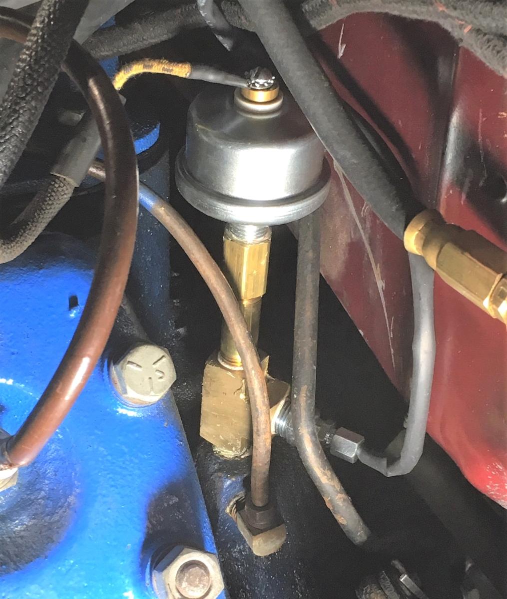

I'm not familiar with the '36 engine, but the picture shows how I "piped" to supply three points; the oil filter line, the pressure sender, and the line going to the mechanical oil pressure gauge, that I installed in my 59AB, '46 Coupe. The line for the pressure gauge looks like it is kinked, but that is just the cover I put over the line to prevent chafing if there were places it would rub, between the engine and the dash. I installed the gauges when I first purchased the car, because the stock gauges were not working, and I didn't want to drive it without knowing the engine status. I learned how to fix the gauges, which I have done, thanks to the members on this forum, but I have not brought myself to remove the ones I installed under the dash.

As 51Woodie indicates, one can find an assortment of brass fittings to accommodate most needs. I added an under-dash tube-fed oil gauge. Speaking of gauges .... I adjusted all the dash gauges to match readings shown on the under-dash oil and amp gauges. Left the stock temperature gauge alone since the sensors are on opposite sides of the block. I added a voltage gauge because charging system was spiking too high and killing my distributors' pertronix ignition module (got rid of that setup and back to a stock points distributor).
