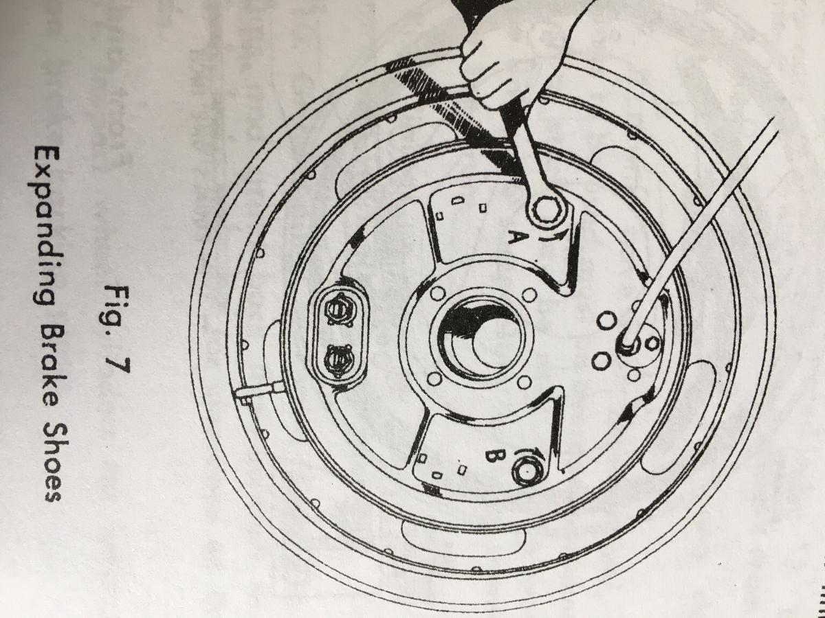

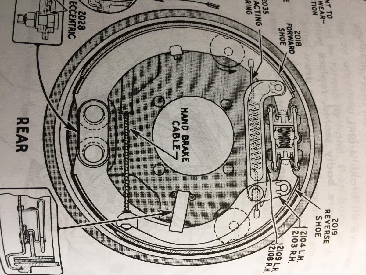

51woodie |
11-13-2023 @ 10:53 AM
Posts: 565
To quote the 1939-48 ford service manual: Anchor pins, )Ford & Mercury 1946-48 Self centering type brakes). On these models, anchor pins are fixed on backing plate and have special elongated washers which engage elongated holes in the brake shoe web. With this mounting, shoes tend to "center" themselves in drum when brakes are applied. It is important that the elongated washers are free to move in the shoe web. Adjustment is made from the back side of the backing plate. Turn each of the cam adjusters (see ref pics) until the shoe is tight, then back off until the drum just turns freely. Note: If the wheels are off, the drums must be secured on the hubs with nuts, when making adjustments. Sorry about the sideways pictures.
