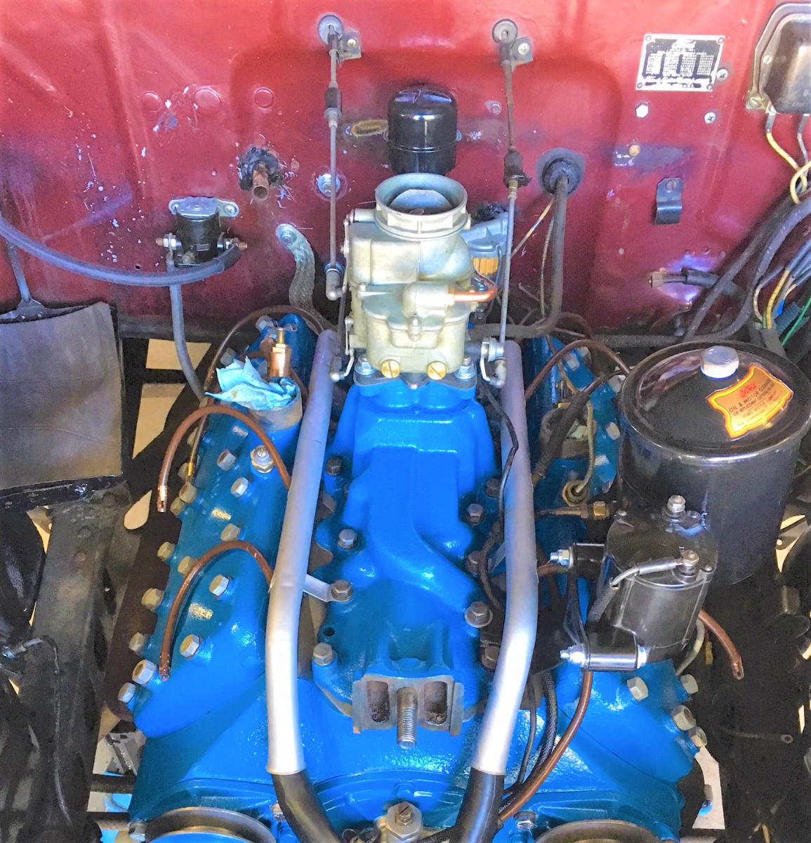

Shelby67
11-07-2023 @ 3:35 AM
Posts: 9
Joined: Nov 2023
Here's the photo from the left side. The breather/filler tube is on the back of the engine, as noted by you and others, and has a trumpet cap (second photo). Thanks for helping.
