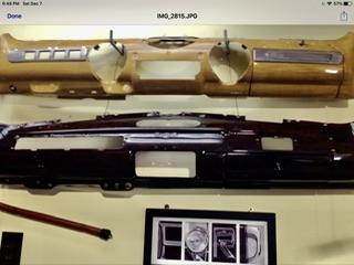

Does anyone know what the Grain-It base color and ink tone is for the maple wood graining used in 48 & 49 ? Grain-It has 2 light base colors and multiple inks.

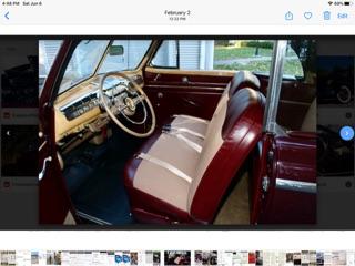

The one on left is light yellow base the top one on right is darker yellow, the ink is maple graining & toner.
Hopefully you can soom in to get a better visual

These pictures got reversed , shows darker base on left.
