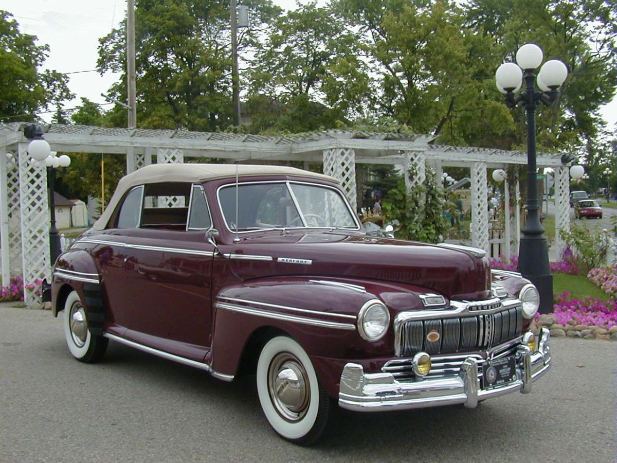

My 48 Mercury had all 4 brakes relined and arched in by Fort Wayne Clutch. I have put about 1000 miles on the car since, and the brakes have never worked well. The pedal is hard, but the car does not slow down and stop as it should. I think the brake lining material used does not have enough friction to slow the car and stop in a normal distanced ( like it did before I put on the new parts).
Can anyone recommend a shoe/lining supplier that has the proper material that they have used with good results. Thanks, Bill Large
