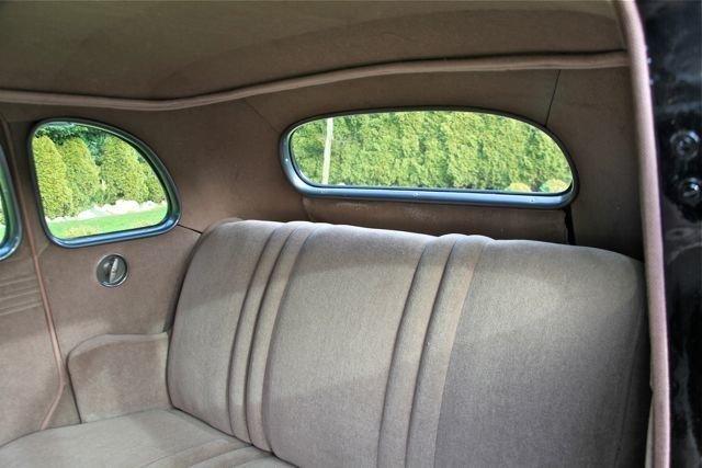

Hello all... I am wanting the metal insert trim piece for the quarter window regulator crank handle. I need a set of these and I'm not sure what they are called. So if anyone can help this old man identify what these are called and even better who may sell them... then I'll be grateful. Thanks! (You can see in the photo below the trim piece that is inset around the quarter window regulator crank)
