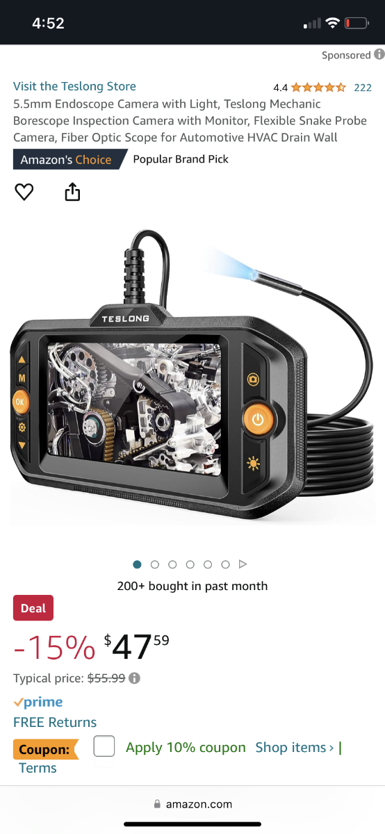

I realize it may be too late to help with this discussion but the endoscope in the attached picture is a wonderful tool for looking into a cylinder head for bent/stuck valves, rust or scorching on cylinders. Very handy for retrieving lost items with the included hook and magnet attachment. It takes pictures and video. For less that $50 on Amazon it’s a great tool.
