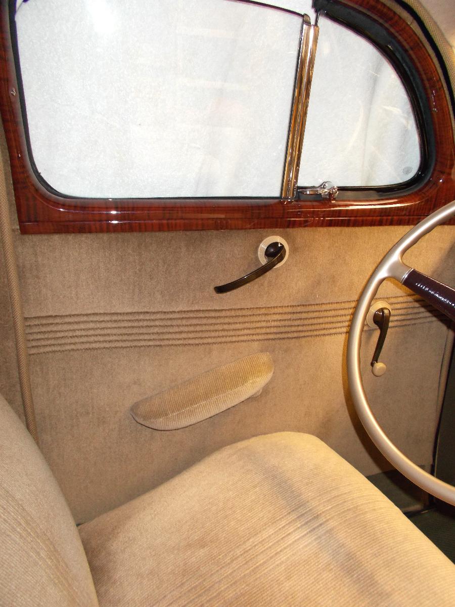

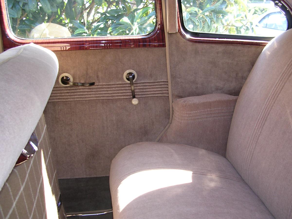

Do rear armrests for a 40 coupe fit a 40 4 door sedan ?. I have the LB upholstery but car came without arm rest mount

Photos attached regarding your armrest question. The rear seat armrest has its own, somewhat uniquely designed upholstery panel that fills the space next to the rear seat cushion and below the rear quarter window. The front armrest is mounted in the approximate center of the door's upholstery panel.
For future reference, you might want to pick up a copy of the Club's excellent restoration manual "It's Ford For '40". It has lots of photos and info on the interiors for the various 1940 body styles and models.
