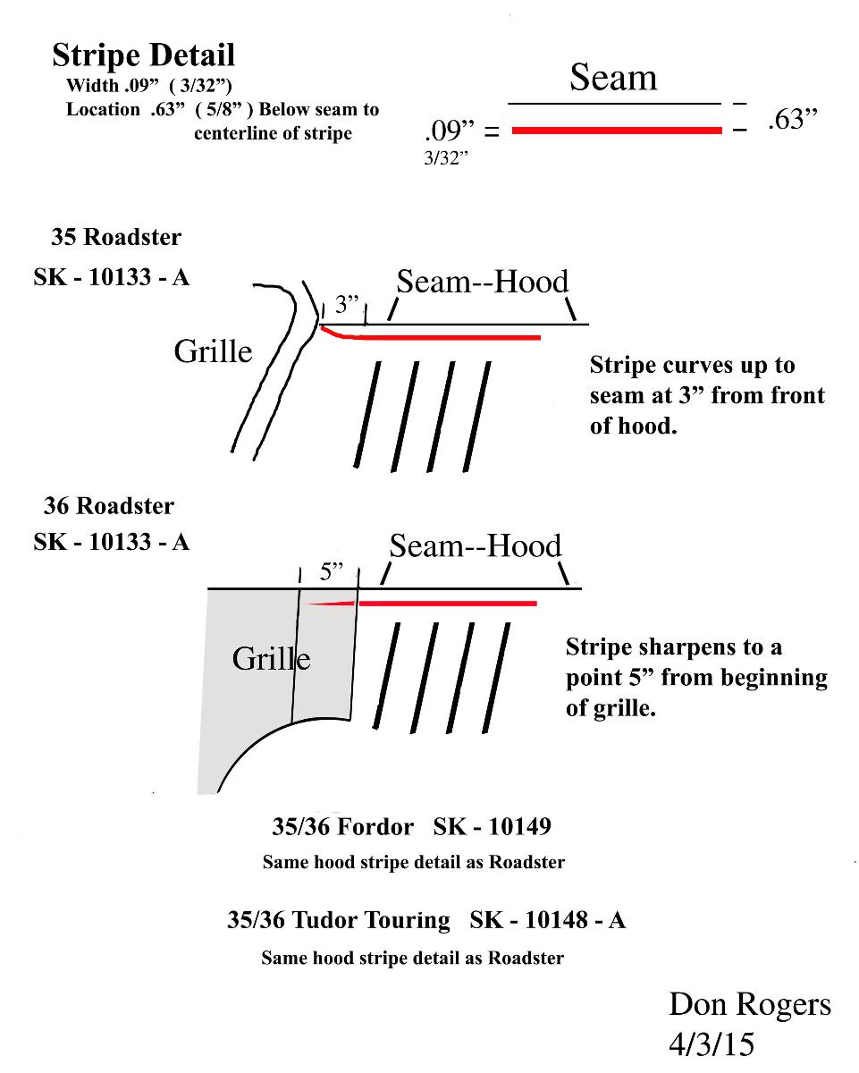

5/8 " down from the body crease; 3/32 " wide. Taken from my original paint and stripe '36 deluxe tudor.

See the post below for two diagrams of the pin stripe.

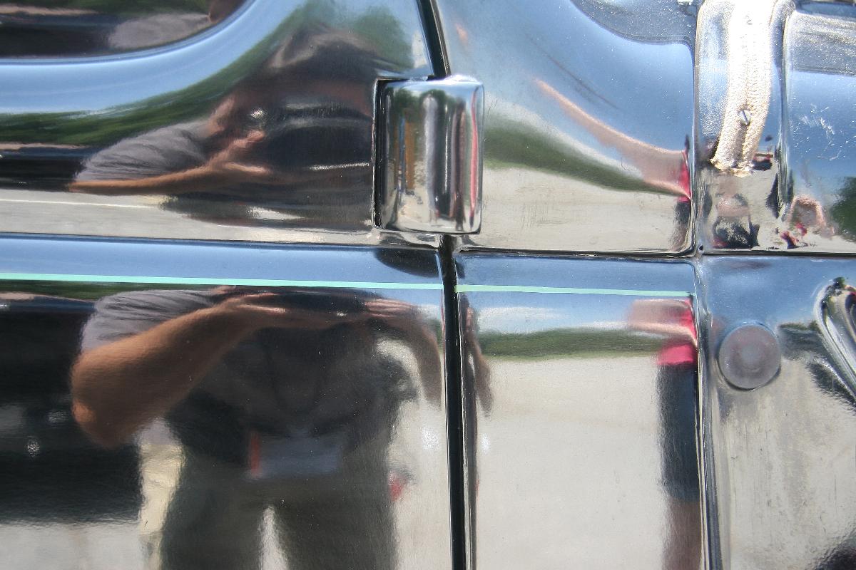

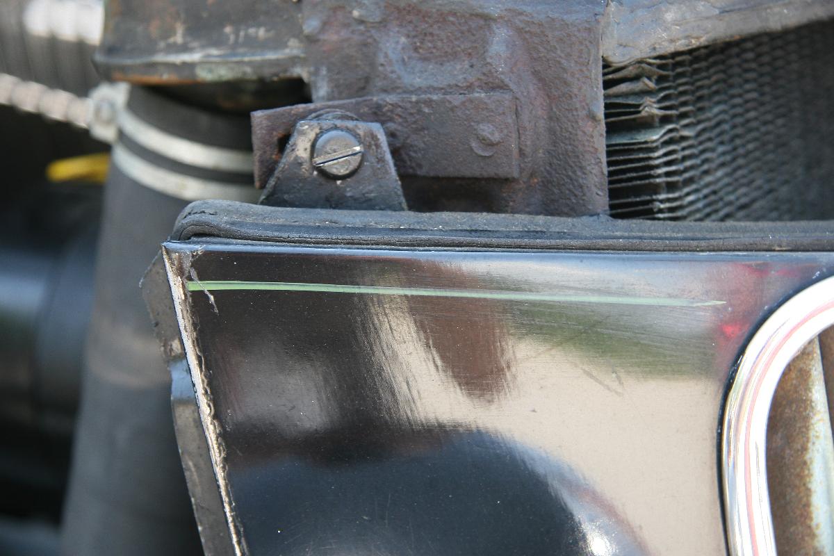

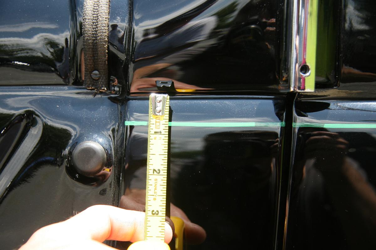

Attached are some photos of two different cars that I took at an Early V8 Ford show a few years ago.

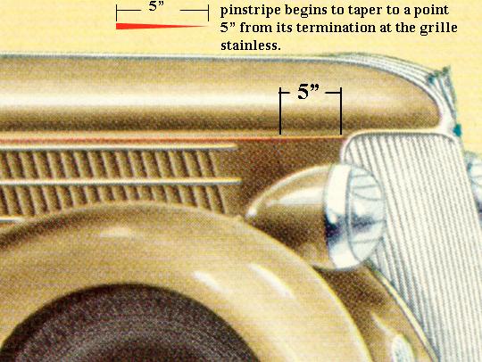

Also attached are two documents I have run across that show details of the pin stripe. These documents may have come from this forum, I can't remember (one is attributed to Don Rogers). Note that one of the cars in the photos has the turned up stripe at the front of the car, but according to these documents this should be for 1935 only. It appears the 1936 models should have the straight and pointed detail at the front. I hope these help.
I can only attach five photos per post, so I will attach additional photos (and the two documents) on a subsequent reply.

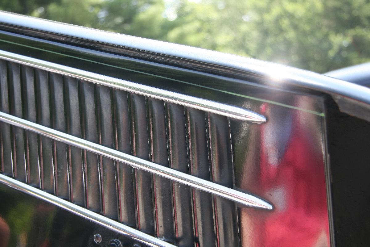

Here are the rest of the photos and the two documents mentioned in my last reply.
