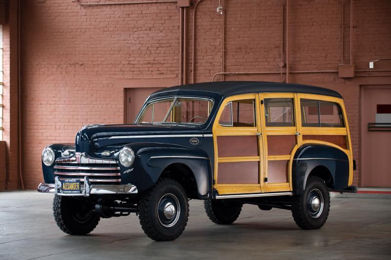

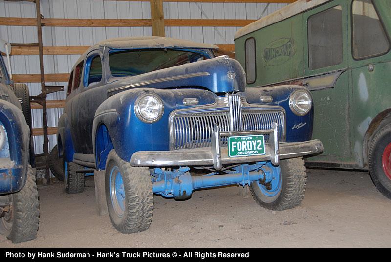

As I recall, the Morman-Herritington 4x vehicles of the 1930's/40.s used the Ford wide five wheels through '48.
I know of two '47-48 Ford MH 4x's in Montana.
Bill
36 5 win delx cpe
wmsteed
08-14-2023 @ 9:49 AM
Posts: 613
More pix of early MH 4x's with wide five wheels
Bill
36 5 win delx cpe
