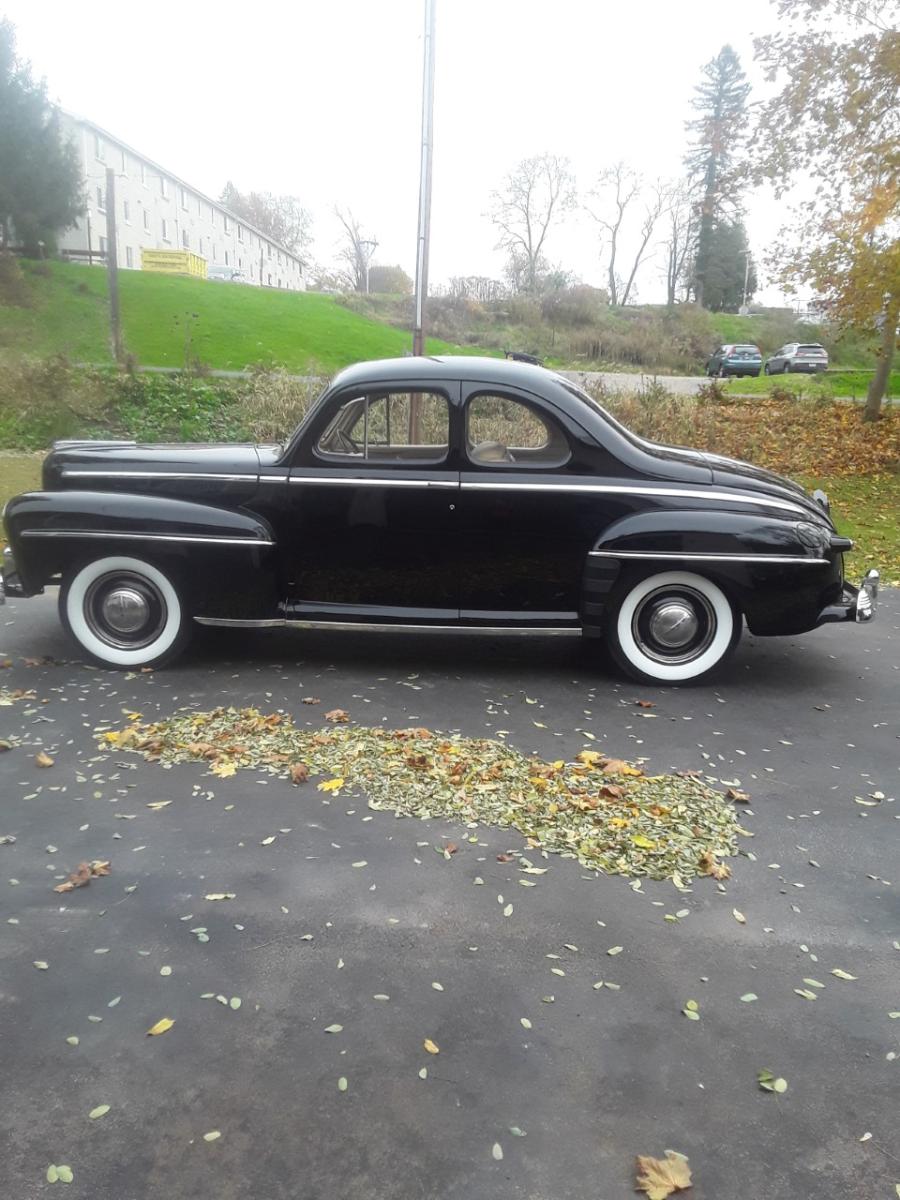

My 1947 business coupe with the 3" Coker whitewall bias ply tires. I think the most I've driven it is 700 miles in a year. The 42-48 cars are easy to drive in my opinion even with bias ply tires. NON of the Early V8 cars drive like a modern car though IMHO but that's part of the enjoyment of driving them. You have to think and be engaged.
