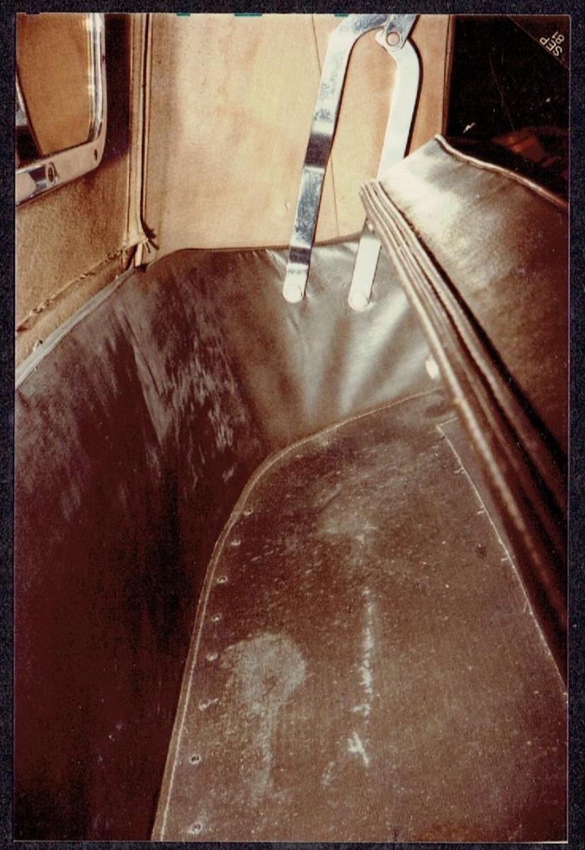

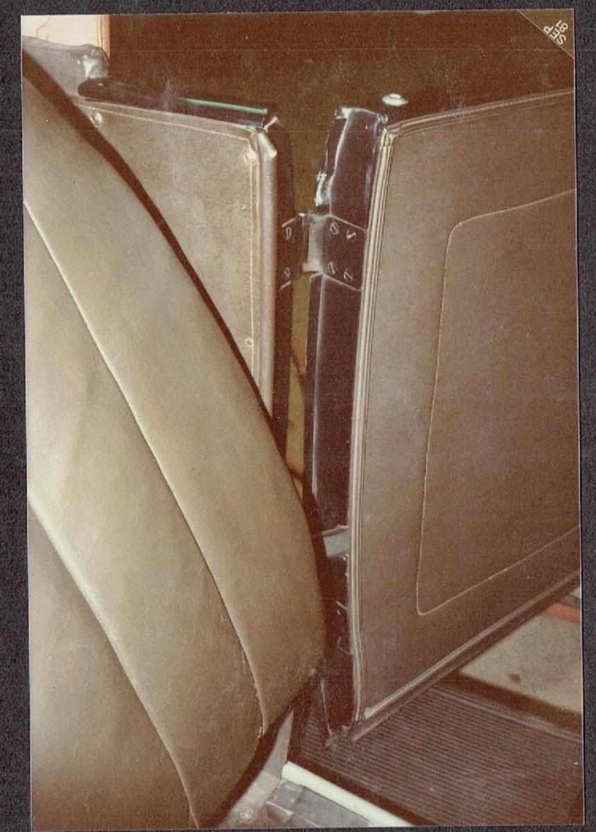

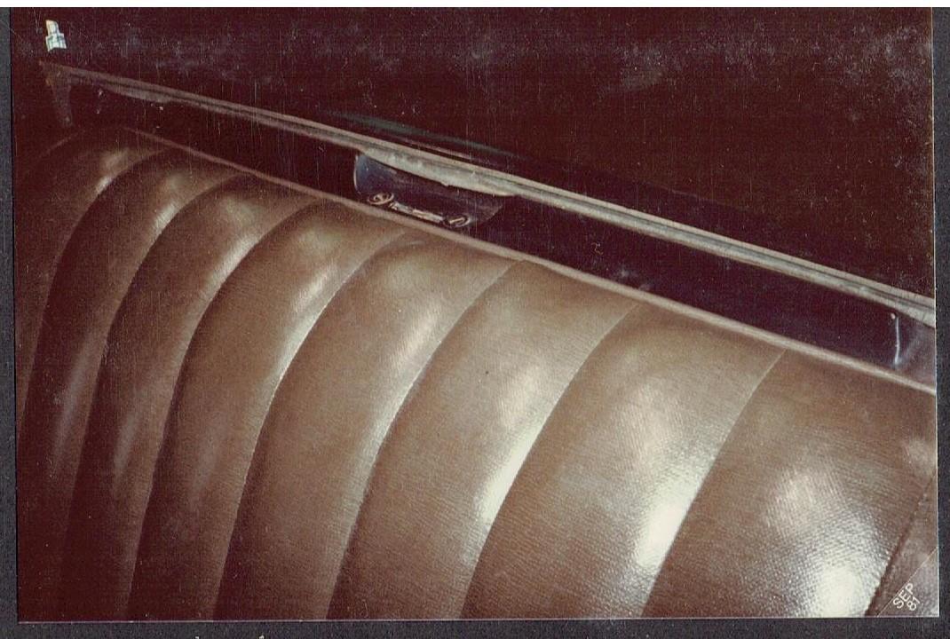

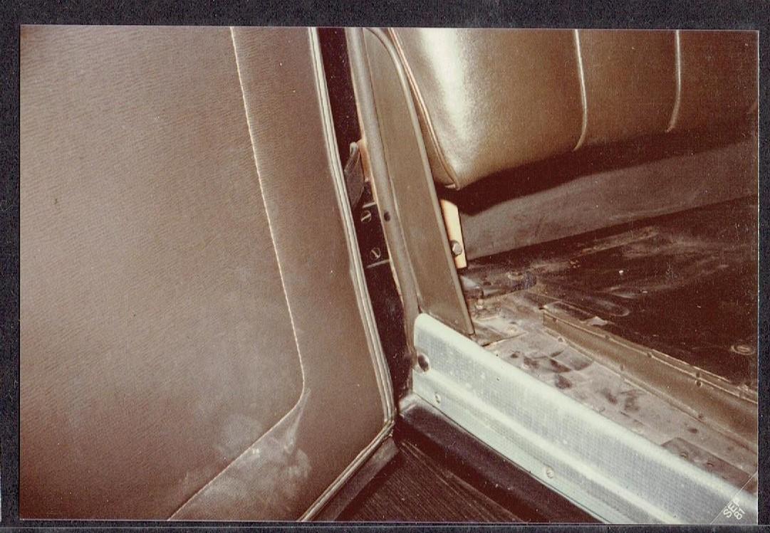

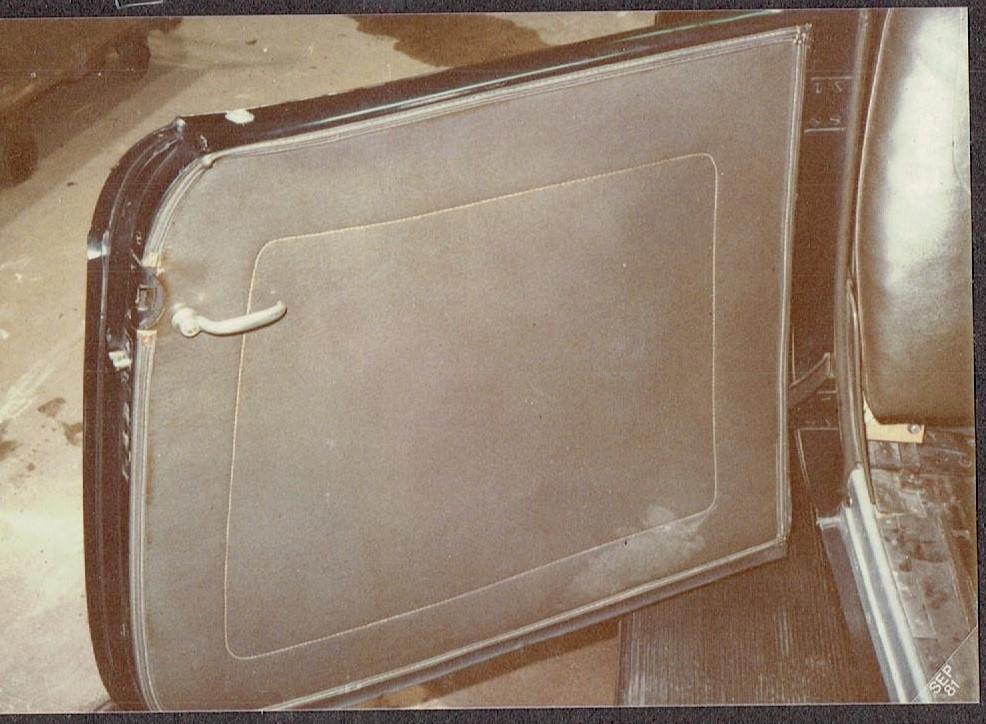

Sorry for the belated response to your questions regarding the original upholstery in a '34 roadster. The attached photos are of a low -mileage survivor with its original interior, top, and side curtain intact and in remarkable condition. Late in the '34 model year the color of the upholstery was changed from the copra drab color in the photos to taupe, a lighter tan color.
