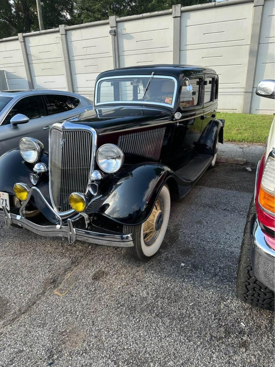

Good morning from Cassville Missouri...home of Roaring River State Park! I recently found my "dream car" , a 1934 Ford Model 40 Sedan in Houston and had it shipped to me. The owner assured me that it was a running driving car his father had had restored in 1978. The car arrived Tuesday and I'm thrilled....except that it won't start. I put a new 6 volt battery in it and it barely cranks if at all. I let the battery charge overnight and this morning when I step on the starter it may have turned it an inch. (yesterday morning I actually got it started, drove it down the road and back but then it wouldn't start again). It has fuel to the carb so it's not that. My mechanic told me not to buy this old stuff so he's no help....I did notice a trickle of smoke coming from the box the starter rod connects to? ANY HELP APPRECIATED!! Steve
