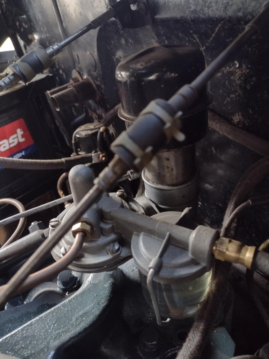

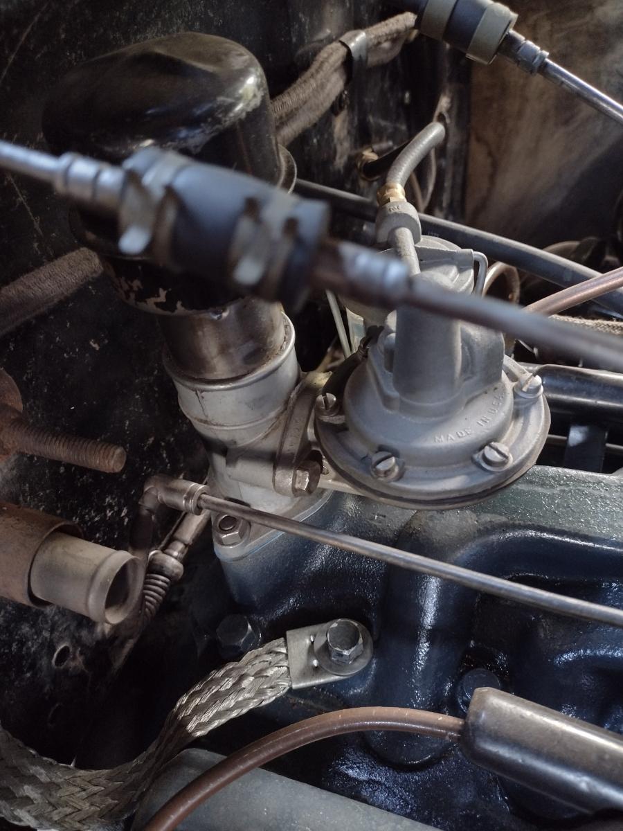

I have a 42,46, and 1948 Fords and this is how I did mine. On the old joint I removed the joint with a Stanley knife. The end on the carburetor I cleaned up the portion going into the joint on the wire wheel on my bench grinder where the end coming from the firewall I scr*ped clean. On the new joint I carefully removed the metal ends with a pair of plyers. Went to NAPA and got two round metal fuel line clips of the appropriate diameter. Lubricated the holes , slipped joint in between the rods then moved the fuel line clips to the ends of the joint. Not the correct procedure for a Dearborn car but I have not had one come loose and they function well. P/N is 91A-9702 from Third Gen.

Here's two photos of mine on the 42 coupe. The fuel line clips may be overkill but I didn't want them to have any chance of coming apart. PM me if you need me to walk you through it. Agree they could've made a simpler set up. We won't even discuss the fan assembly.....

1942deluxe I see your flex joint has exposed metal each side of the rubber connection; my existing doesn't. Regardless I'll cut away the rotting rubber and use a piece of stiff hose and clamps. Regarding the "fan assembly" - agreed. It's just another maintenance item and I seem to spill some of its oil when I have to remove/replace it to work on the distributor. Considering my non-concourse vehicle, Bob Dake is selling a replacement that has a sealed bearing instead - no maintenance. I went for it - perfect fit.
