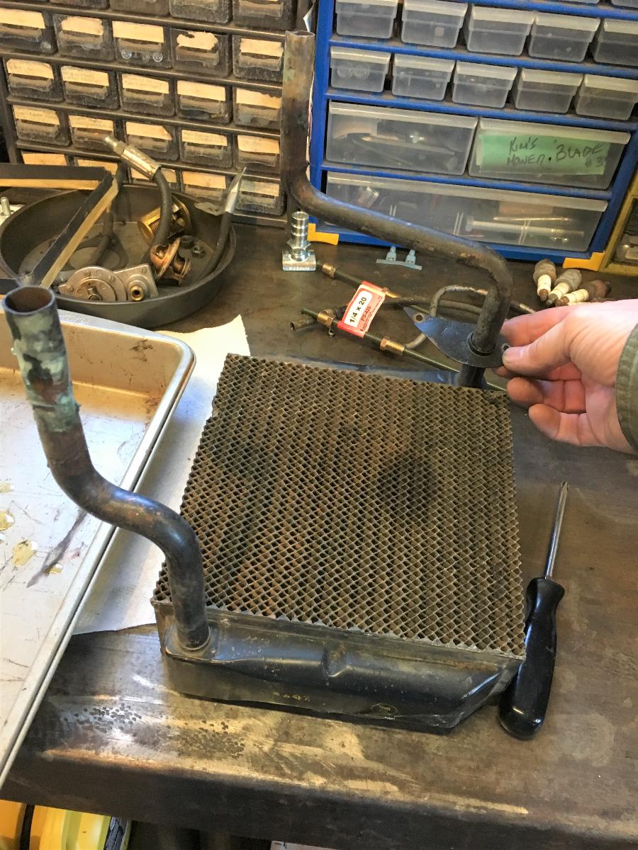

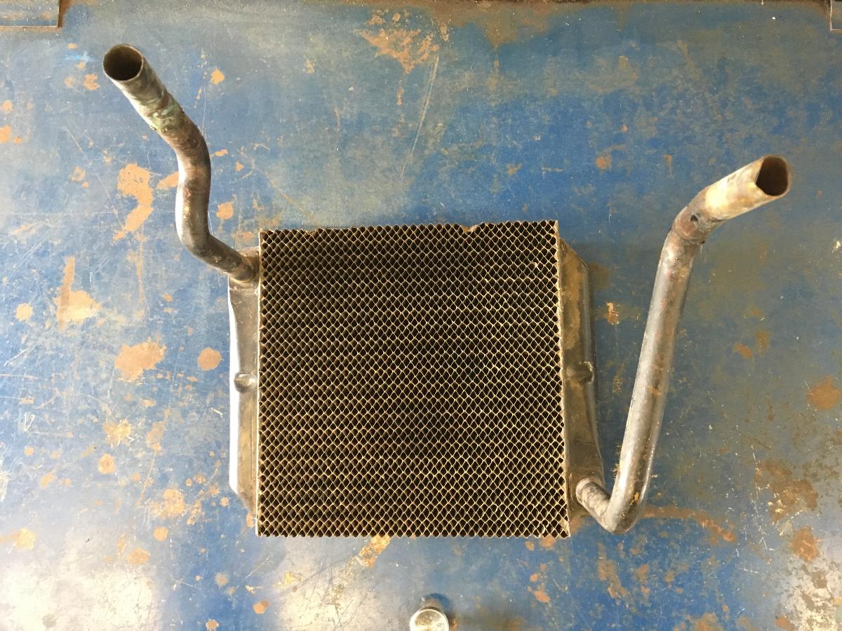

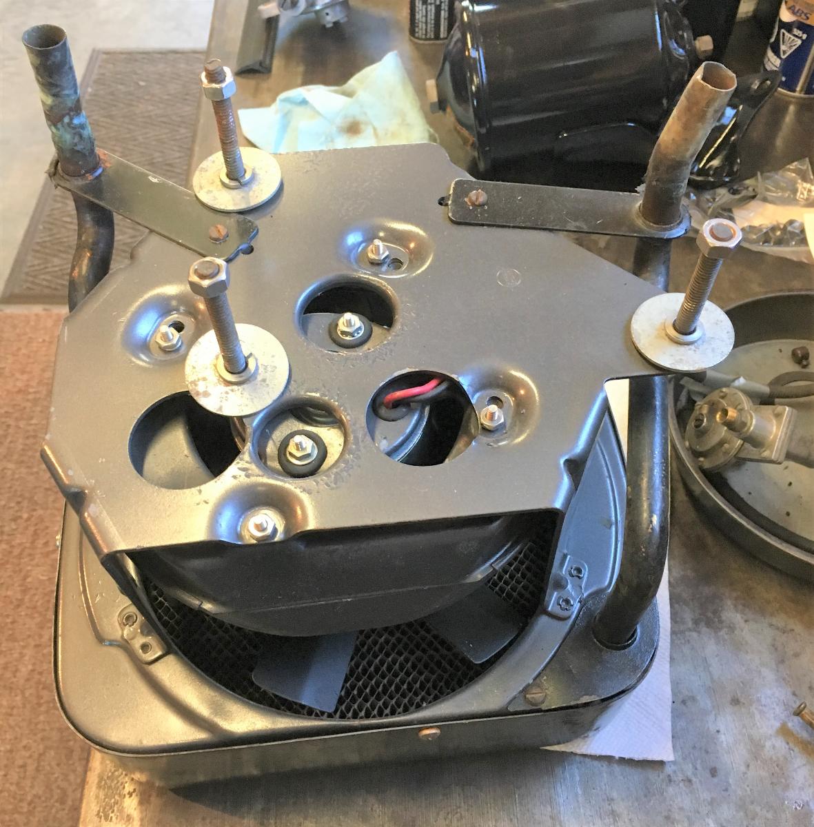

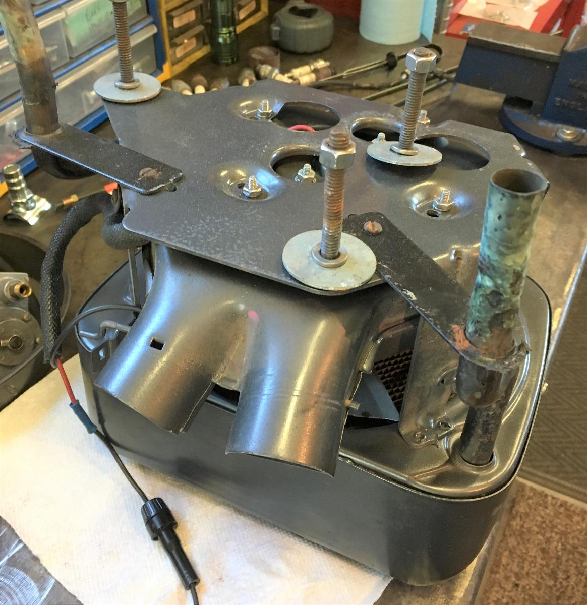

06-19-2023 @ 8:12 PM
It's just as Kubes says, to remove the heater assembly. You can pinch off the heater hoses under the hood before disconnecting, but there will be some spillage of coolant. I put some old bath towels on the floor under the heater before I pulled it out. The reason I took mine out of my '46 Coupe, was to have it flushed and pressure tested, and found it to be in good shape. Attached are pictures of the heater out of my '46.
