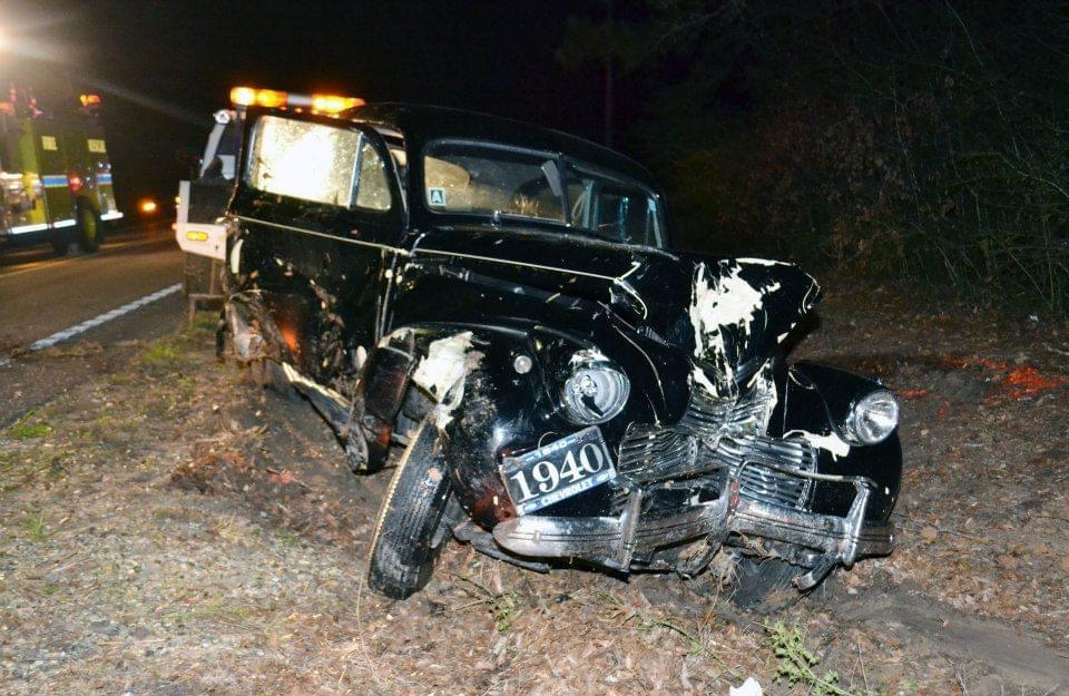

This is why I have doubts about running a 6v system at night...
