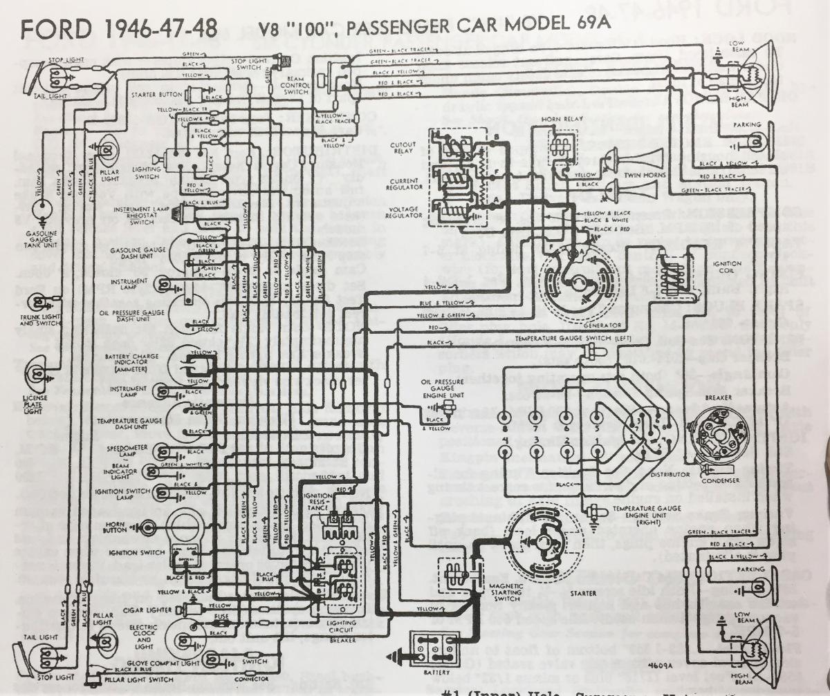

Looking for the easy way to change the circuit breaker on a 1948 ford. The circuit breaker is behind the dash just above the gauges for the fuel , oil, amps and coolant. Also I have the original 51A-12258 which shows four contacts

Not sure what you have there. However if you have the 41 to 48 Ford book there are three or four pages of wiring diagrams that should show you the information you are looking for.

Blase, There is no comfortable way to work under the dash unless you are about 18 years old, or have taken the front seat out. The B-B terminal has a link for the two studs, as there are two yellow #10 wires to be connected. One from the voltage regulator and one from the ammeter. The H feeds the headlight circuit, and the A feeds "accessories" such as interior light and dash lights etc.
