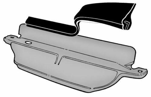

Shinton. I'm not sure how similar the rad and sheet metal around the rad compares between your '41 and my '46 Super Deluxe, but in the picture you posted, the top "shroud" in front of the rad seems the be missing. The lower "shroud" may be missing as well. These two items, as well as the rubber sealing strips for both shrouds, are critical to ensuring air flow through the rad, instead of around it.
After a second look at your picture, I see that the top of the rad is a lot lower than an original rad, so even if the top shroud was in place, it would be open at the back, sill allowing air to bypass the rad. You could fabricate some sheet metal to close off the gap at the existing rad.

As others have mentioned having a fan shroud and all the proper ducting is key to getting maximum air flow thru the radiator. Some years ago one of the street rod magazines did an article on cooling and it was amazing how engine temperatures changed simply by removing a shroud or air deflector.

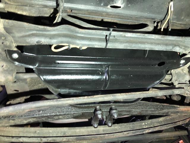

I have the lower shroud, but not the upper one and no sealing strips. Also, the lower one may not fit well enough as air can pass between the lower sheet metal and the aftermarket radiator. I may try some experiments with some sheet metal! I had no idea about this. Thank you!
