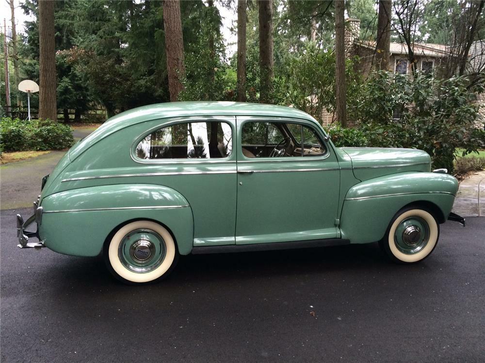

In SUPER DELUXE sedan, 85 hp, 3 speed, what type of fluid does one change?
Is it special, or just a type available in any car store?
What types and sellers do you use?
Manual gives Oem pt nos beginning with M- but nothing comes up in google?
Same questions, except as to shocks
